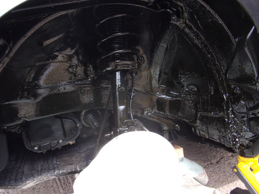

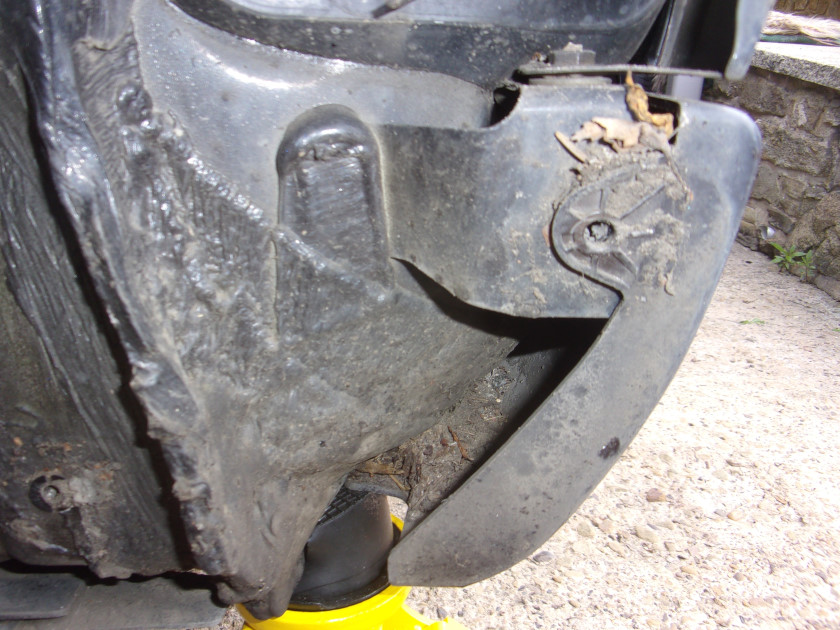

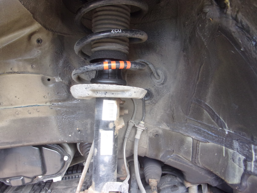

Liner removed and much better than expected.

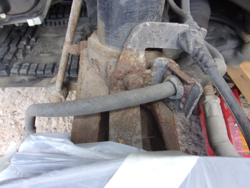

Exposed suspension with rust so caught it in time before it gets worse.

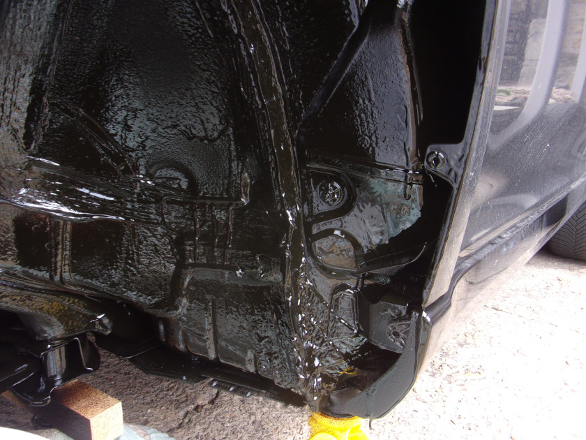

Usual problem area bottom of wing. but still good.
Wing liner which gave me so much fun.

Brake covered with white plastic bag. Heavy coating of rust proofing applyd using compressor with spray gun then going round with brush to catch the parts the gun couldn't reach.

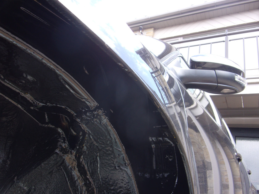

Problem area now given lots of extra rustproofing.

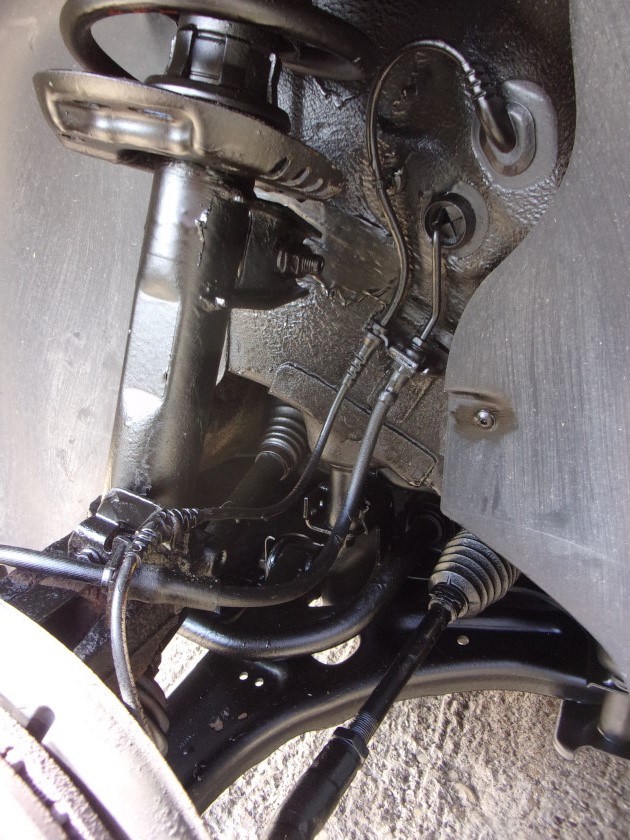

This should last for many years it being further protected by the wing liner.

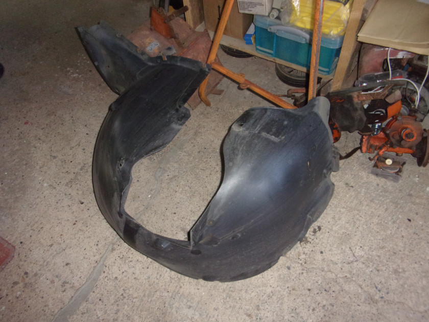

Wing liner removed. Seen nearby is the vintage Howard Bulldog petrol rotavator I'm restoring.

Tidy looking assembly. no brake dust?
