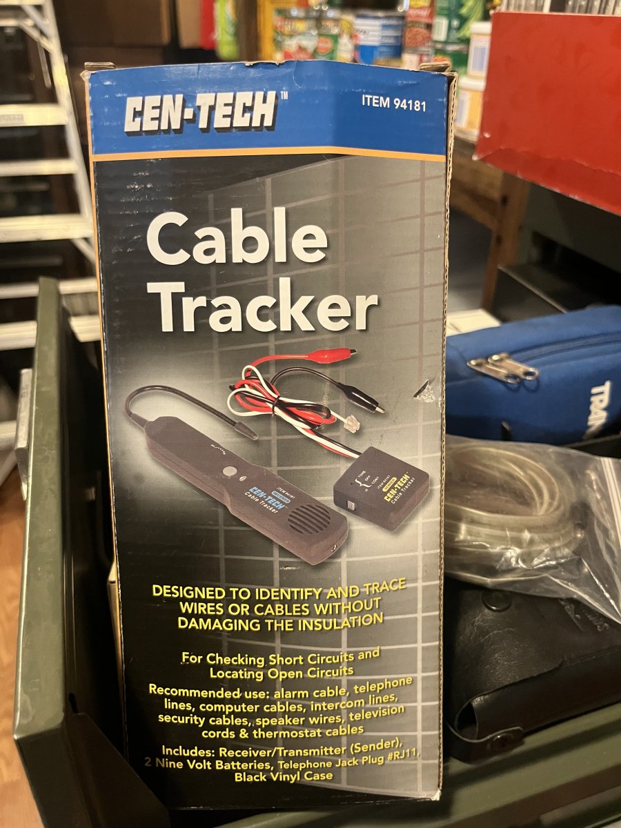

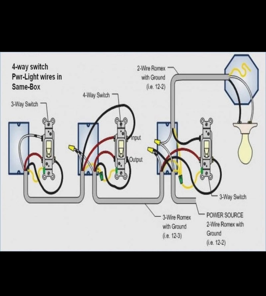

Mr Brad, I am not a professional electrician but have done a lot of electrical work.
It sounds like who ever wired it took a hot wire from one of the 3 way switches in the dining room and feed the vanity or vise versa.
3 way wiring can get confusing.
If I were you I would open each switch that is involved and try to figure out what wire is what. If the vanity light switch is close to any of the dining room lights I would look closely at the wiring of those 2 switches. I also would get a wire tracer to help with that. Harbor Freight should still sell one cheap that works great or Amazon.
Hope this helps.
