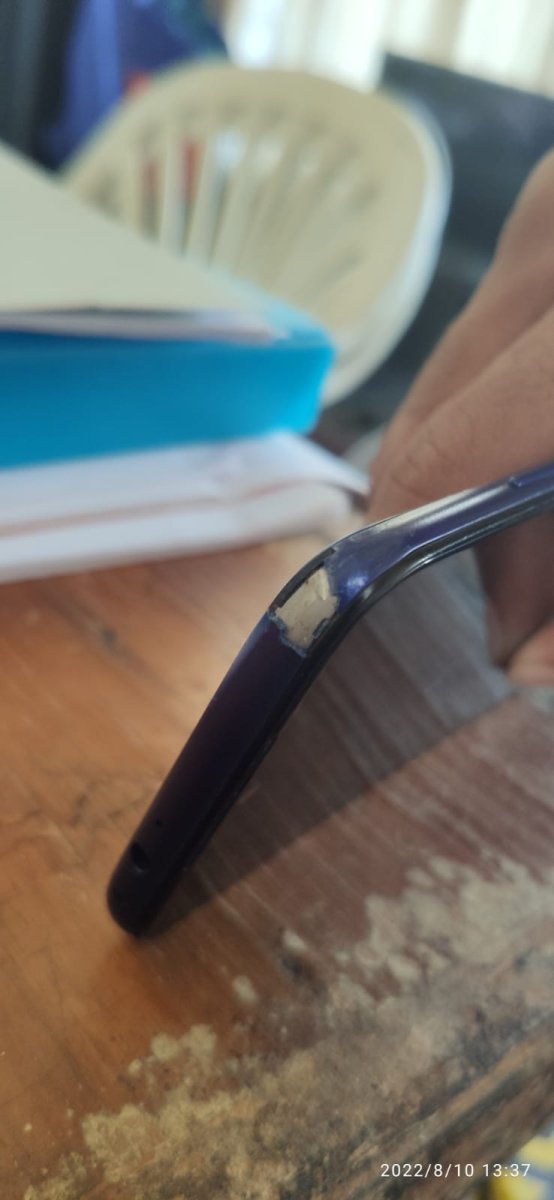

My phone Fell and part of it was Broken. I was lucky it Fell on it's Edge instead of the screen. I can Now see the Iron in my phone and it looks kinda ugly.
I am wondering which DIY trick I can use to fix this.

I would get some 2-part epoxy glue, black in color when dried. It is available at lost larger hardware stores, or likely too on Amazon. The glue comes with two (2) chemicals/glues. When mixed together (ratio according to the manufacturer), the glue dries in about 15minutes. You have little time to use it. But its consistency is such that it is self-levelling, so hold your phone in such a way that the wet glue spreads/pools out into the crack. Redo it an hour later if it settled too much.
