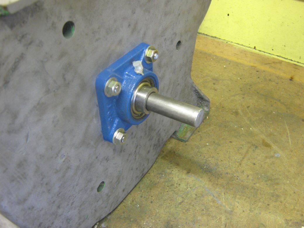

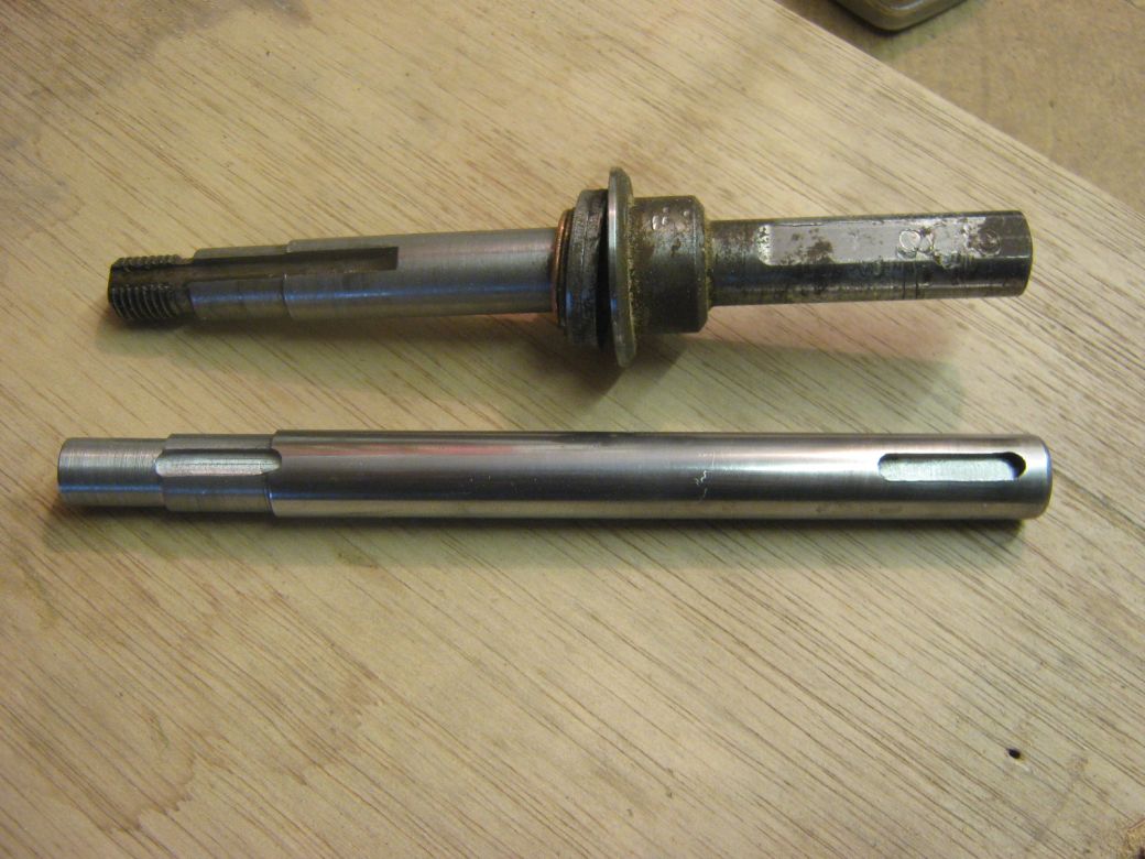

The new drive shaft installed with a heavy modification; the new bearings are definitely not standard but any future bearing/mounting problems won't be difficult to resolve because these bearings are readily available and cheap.

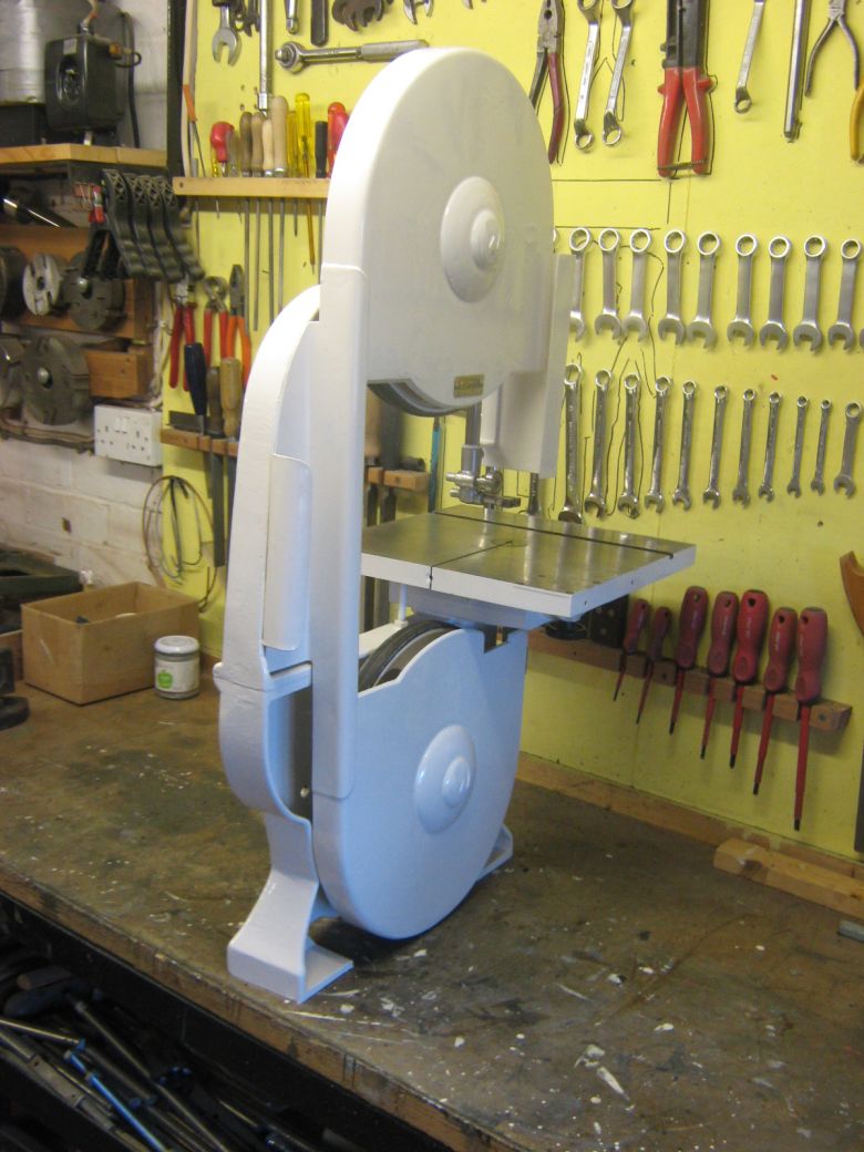

The Wilmac main body completed now requiring a motor; this is what I call refurbishment. A brush paint job made a lot of difference and I now use this bandsaw a lot.

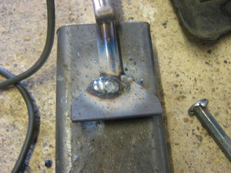

I needed a short tool post for one of my woodturning laths so set about making one; here it is looking very rough after welding.

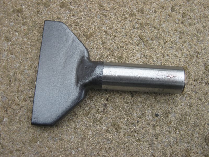

Here's the same tool post completed; it cost virtually nothing and I could have made it any size I wanted.

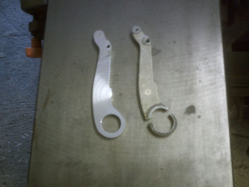

Here's a wire guide arm from a rare AVO Wave Winder; the machine was scrap without the arm working so simply make a new arm from an offcut of aluminium. Cost nothing again.

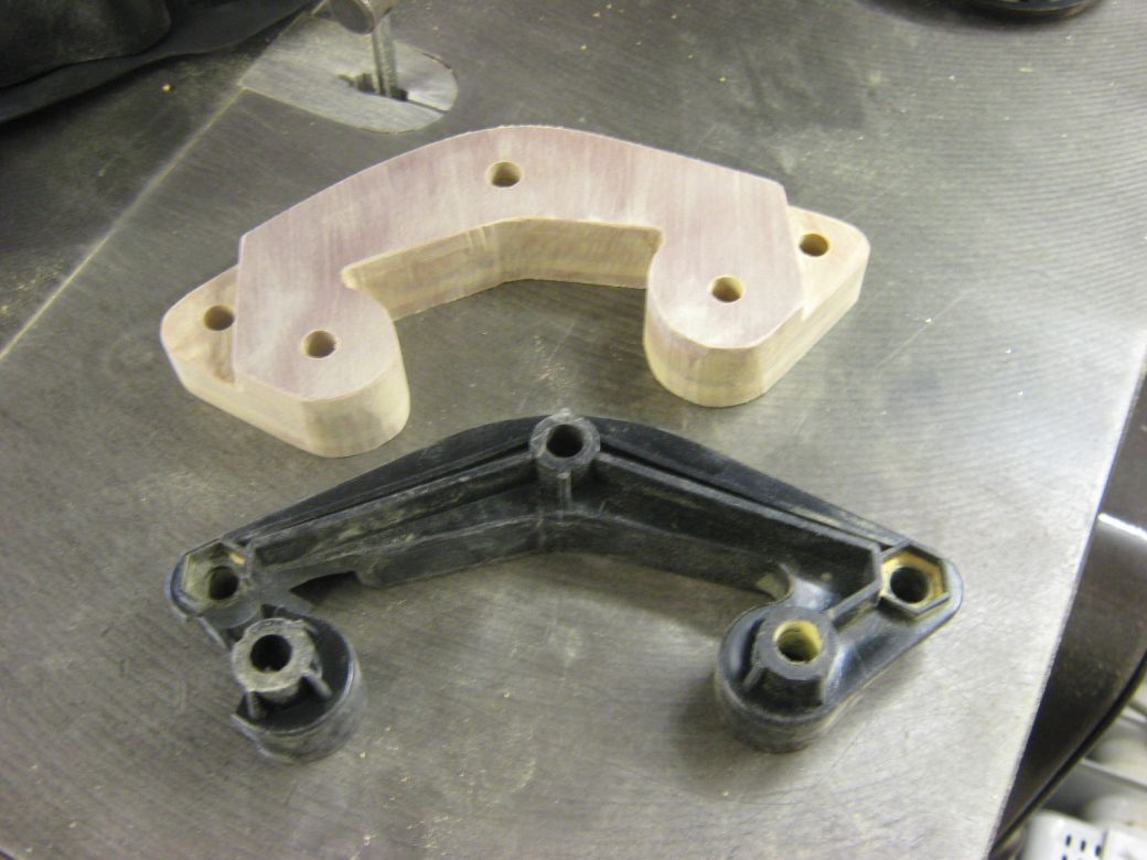

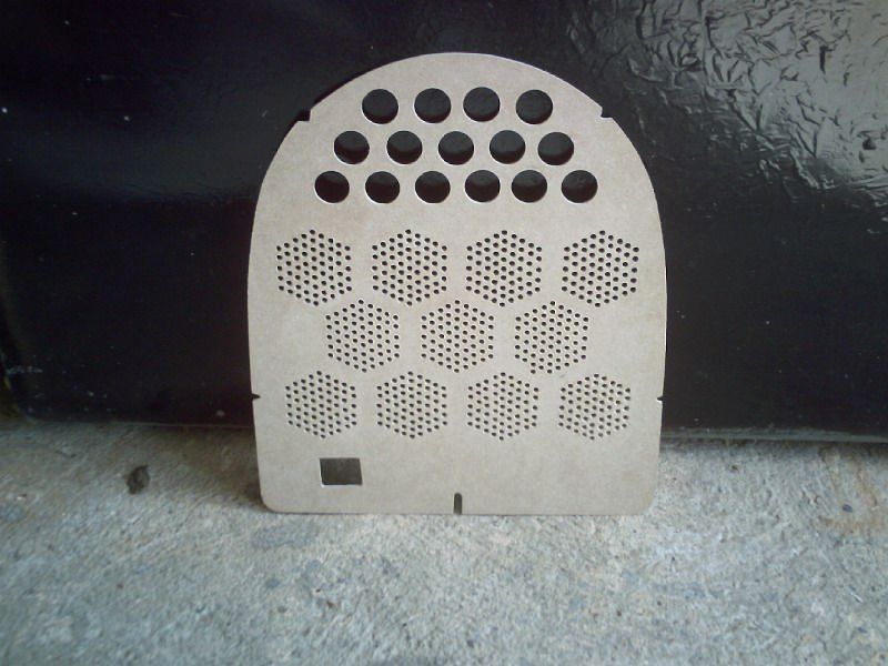

A friend bought a Peoples set back cover (vintage radio) through eBay but it never arrived and these are rare; he had borrowed a cover and was going to attempt copying drilling the 720 holes my hand? I suggested if he buy a full 8' x 4' sheet of MDF I'd have a go for him; I made twenty of these back covers doing them in two batches of ten taped together. This is one of them.

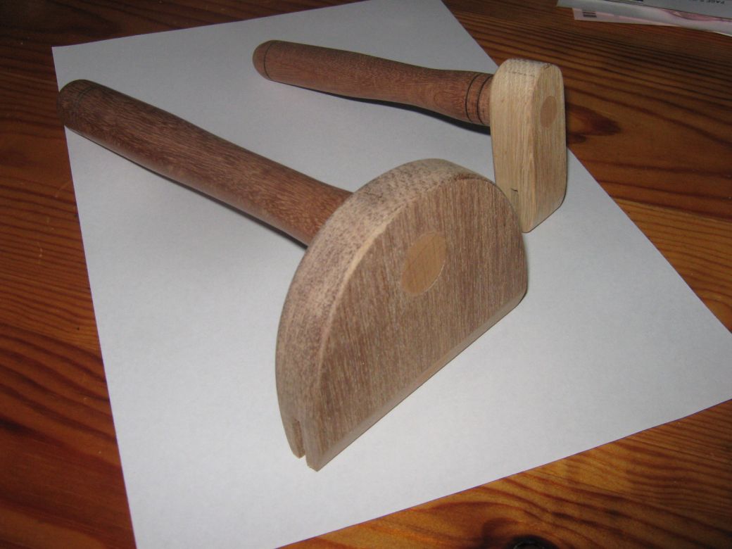

During my vintage radio restoration years I made lots of useful things; above are a pair of veneering hammers awaiting brass blades to complete them; I did lots of veneering using these.

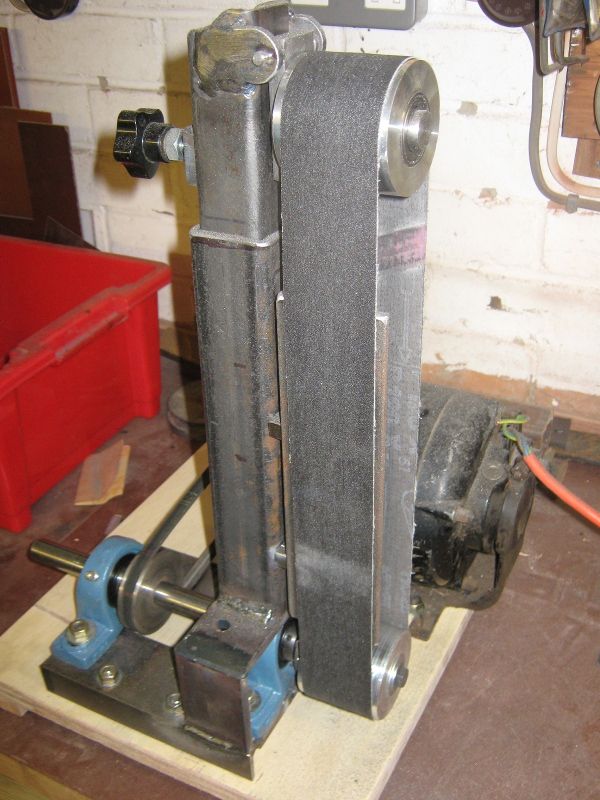

My home made belt grinder it having 2" x 36" abrasive belts; I have a selection of top quality belts from Aluminium Oxide to Zirconium. I've made grinding guides and can even grind a "fingernail" profile on my woodturning gouges; the biggest expenditure were the belts.

This might interest you Bill; when I laid the flags onto bedding mortar due to the slope as I tapped them they wanted to head down the valley; I started with the two bottom flags then used 1" thick spacer blocks of wood to prevent the flag sliding; in order to lift the flags I designed and made a pair of lifting handles; I could then straddle each flag; lift it and gently place it in position; it worked a treat and I laid lots of these heavy flags; mixing the bedding mortar by hand however was harder work.
The pair of flag lifters I made which worked a treat keeping my hands and fingers safe.
