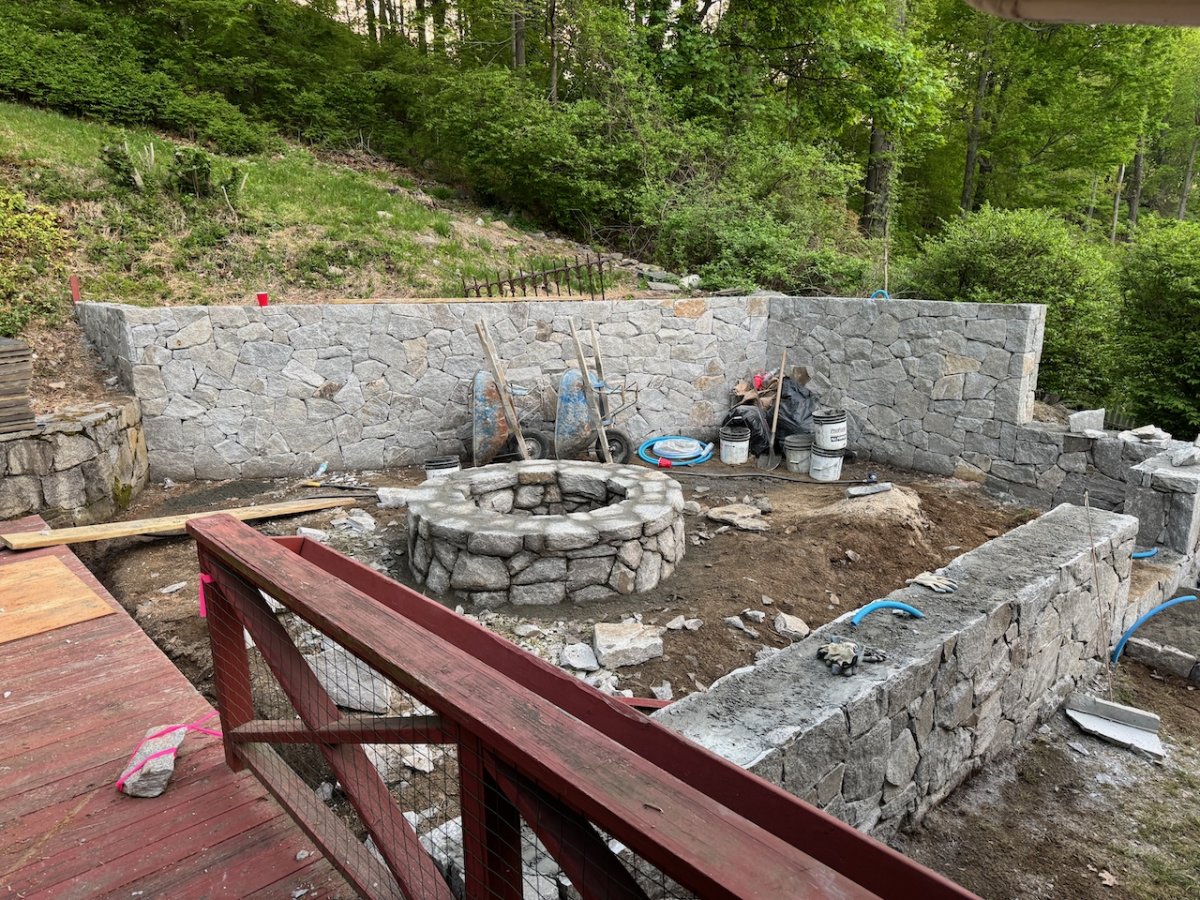

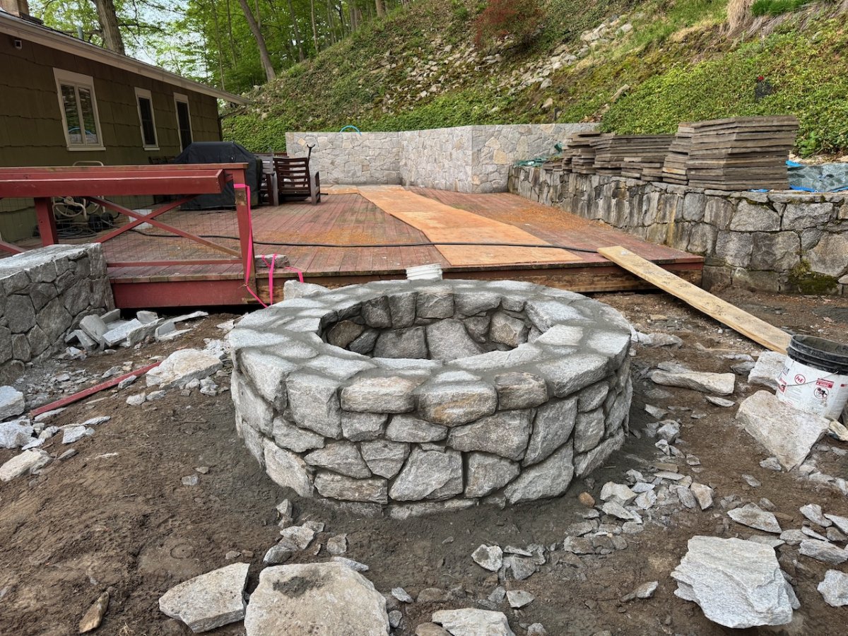

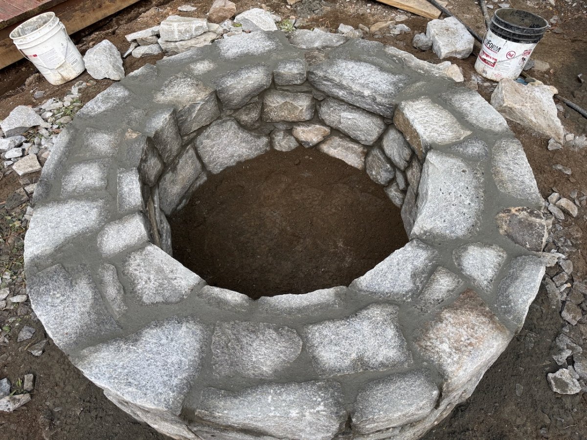

Here are pics of the fire pit. Thanks for your help.

View attachment 6283View attachment 6284View attachment 6285
Yeah, I’d definitely be a little concerned too. Fieldstone looks great, but it’s not really meant to handle the high heat of a fire pit on its own. That’s why fire bricks and special heat-resistant mortar are usually used. They hold up better and help protect the outer stone. Regular cement and stone can crack or break down over time from the heat. If it were me, I’d ask the contractor to stick with the original plan. You want it to last, not fall apart after a few fires.
