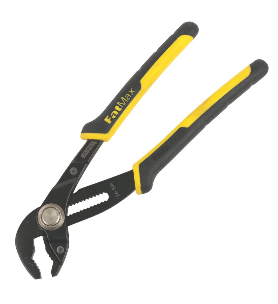

Hello Colin
When you say packing, I know what you mean.
An engineer might refer to shims.
Looking at the picture, the fridge or whatever probably came with an adjusting spanner.
Loads of ways to turn that. Narrow jaw Moles, pump pliers, even a punch or old screwdriver to gently tap on one of the points.

Thin jaws, and jaws open really wide, should assist in grabbing the foot of the adjuster?
Sols as " pump gland spanners" or similar. handy tool for grabbing is a tight space?
