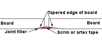

MESH TAPE. It was applied terribly and filled over even worse so it bulged our really badly.
It's meant to be used on joins between taper edged boards and then filled or skim-coated over:
You look to have square-edge boards, so filling is always going to stand proud. Even with T/E though you're on a hiding to nothing if you just want to paint the walls - even a really good job of filling will show. If you paper you'll be in much better shape. If you want to paint, put up some heavy-duty lining paper first But see below.
I tore into it and now I don’t know if I should just fill with polyfilla all purpose (as planned) or use something else and/or if I need to use tape at all?
Assuming square edged boards, if you just fill and paint it will crack. Heavy lining paper you have a good chance of working. Tape will stand proud if the edges are square. See below.
