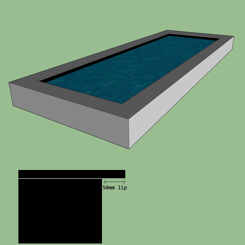

I've got a small pond in our back garden, but we've had problems with herons eating our fish - so we're putting a net in place to try and prevent it from happening again. This seems like the only sure way of stopping it, but I want to try and do it so that it's as unobtrusive as possible and easy to remove as needed.
There's a 50mm lip from the coping over the pond, so I'd like to affix the net under here. My thoughts are that if I add hooks at intervals around the pond (it's only a couple of meters long), I should be able to stretch the net over the surface of the water. Normally, I'd just drill and add the hooks that way, but they are reasonably fragile and I'd hate to have to re-lay them after only just doing it a couple of months back. I know that a frame would be easier, but it wouldn't look as unobtrusive if it covered the whole pond.
What would you use to attach hooks to the underside of one of these copings without drilling? They will no doubt get wet from rain and pond splashes.
I'd be really interested to hear your ideas and thoughts on this one, as I want to make sure I get it right first time. Here's a quick sketch of the pond:

Hi Ian
It's such a shame to have to net a pond. I remember trying to sort out the very same thing some years ago. My pond was the same shape as yours, but a lot bigger. I think I tried just about everything to stop the herons. Ended up with what was really a modified electric fence with the supports for the wires drilled in just below the lip. Eventually got fed up with the slight noise that created (and the fried snails) By that time the fish had got so big no heron had a chance.
Here's one idea that with a 50mm lip you may get away with - - Take some treated timber, only something like 25x25 or 19x25 screw in some hooks, and fix under the lip with solvent free Gripfill or similar, a couple of clamps may be needed for a while till set. I doubt if that would be all that visible.
I can't think of any hooks that would work on their own, they would have to have a very large surface area for adhesive use.
If you have to resort to a frame, how about making it from 15mm copper, a lot less obtrusive than timber. I've seen it done, not bad if you can sort of sew the net on.
I think I may go down the treated timber route - it's the only reliable way I can think of whilst training to keep the aesthetics.
I'm currently testing some glue I saw at Wilkinsons which proudly announces that it sticks to stone, glass, some plastics, metal, etc... It's water proof too. I'm going a test bond with some hooks to a small piece of flat slate. It takes 24h to fully cure, so I'll see how it holds tomorrow. If it does, I'll try sticking some of these plastic hooks directly underneath the lip and see if they stay put.
I've also considered using some black conduit and making a frame that I can just drop in the water - I've got about 20m of the stuff in the garage, so I could do with using it up!

The hooks didn't work well enough after all (the hooks held, but the mesh couldn't be pulled tight enough without sag). I've resorted to building a slim fitting frame after all, using some PVC corner to sit on the lip:
Oh well, worth a shot :).
