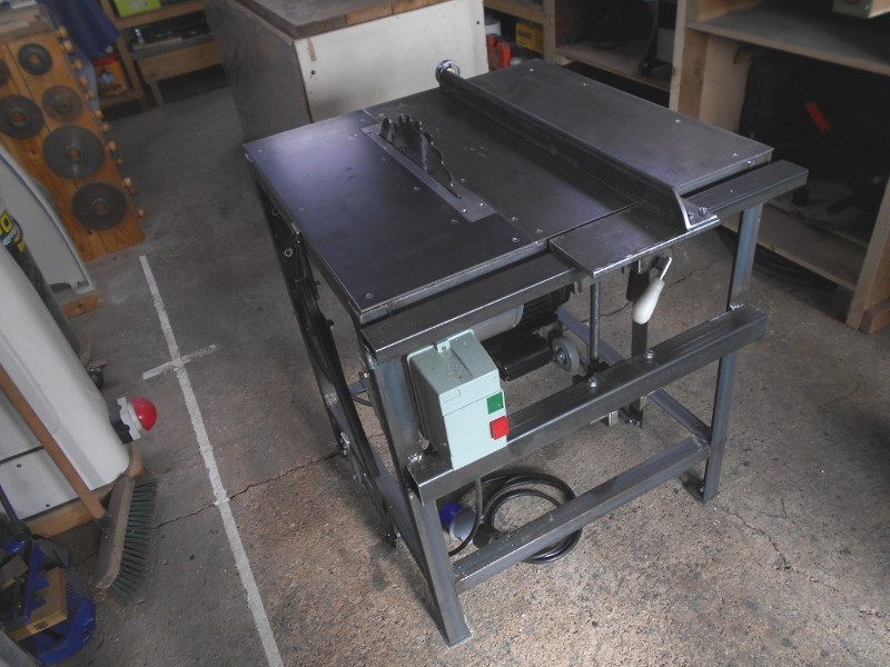

Above is just one of many YouTube videos which might help you. My big radial arm saw doesn't have a fence but it still needs very accurate adjustment; Don't rush whilst adjusting take plenty of time to get it just right; below is a picture of the saw bench I designed and built from scratch; it's 4hp single phase and if it wasn't adjusted correctly I'd soon be wearing timber in my face. If your timber is binding then your saw is out of adjustment; one other point though if the timber being sawn isn't straight and without twist the saw will object and be dangerous. Please play safe. Have you got a decent length push stick?
4" depth of cut on 4hp. Please note riving knife is installed for safety.
