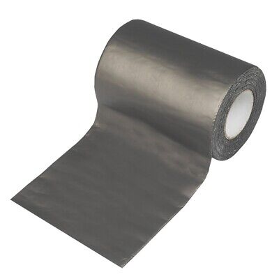

If it's a pitched roof.
As an inexpensive solution you could get a length of timber say six inches wide cover it with roofing felt and fix it to the roof of the shed and the wall at an angle, then use some adhesive flashing between the top of the wood and the wall. Then a bead of silicone between it and the shed roof.
Or to be less noticeable, put a bead of silicone between the new addition and the wall and the shed roof.
The rain would then run off the roof on each side where the new piece meets it, so you may want to think of a way to get that away from the foundations of the house
