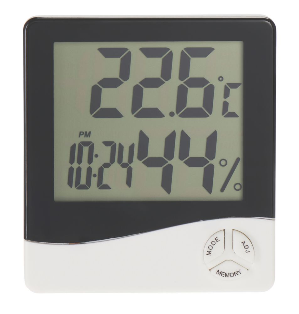

Hi I bought the below,
In the affected room it showing 60-64% humidity, I did have the property RICs checked when I purchased it, no issues with damp were found upstairs. Only a small issue downstairs. Do I purchase a humidifier and do I need to consider having someone inspect the property long term?
A dehumidifier not a humidifier! ;) My nonprofessional advice is - if you have children in the house have it inspected professionally. Mold and mildew can have long term disastrous effects on children. If it is just you, get the dehumidifier, wash the walls to remove all the mold and wait to see if it returns.
