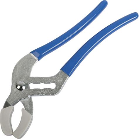

You might need one of these to do the job. You can find them in any hardware store.

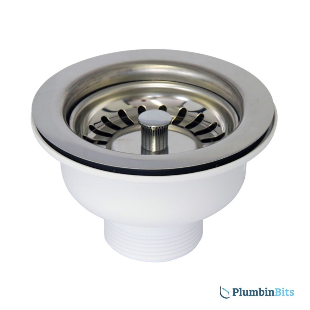

It's hard to see, but that metal ring at the top of the threaded bolt needs to be unscrewed to release the plug hole insert.
It looks a bit of a mess under there, as if it's been on and off a few times, by the state of the thread. I'd be tempted to replace the lot. It wouldn't cost much.
Take the plug hole insert and the photo in message #8 to a plumbers' wholesaler.
I don't like the look of that "yellow" stuff." It suggests to me that the seal of the overflow receptor is likely the cause of the leak. I'd replace it . It looks like this. It should only need that black seal to fit against the underside of the bowl to prevent water escaping. But the underside of the bowl will need a good clean up to make sure you get a tight seal.
