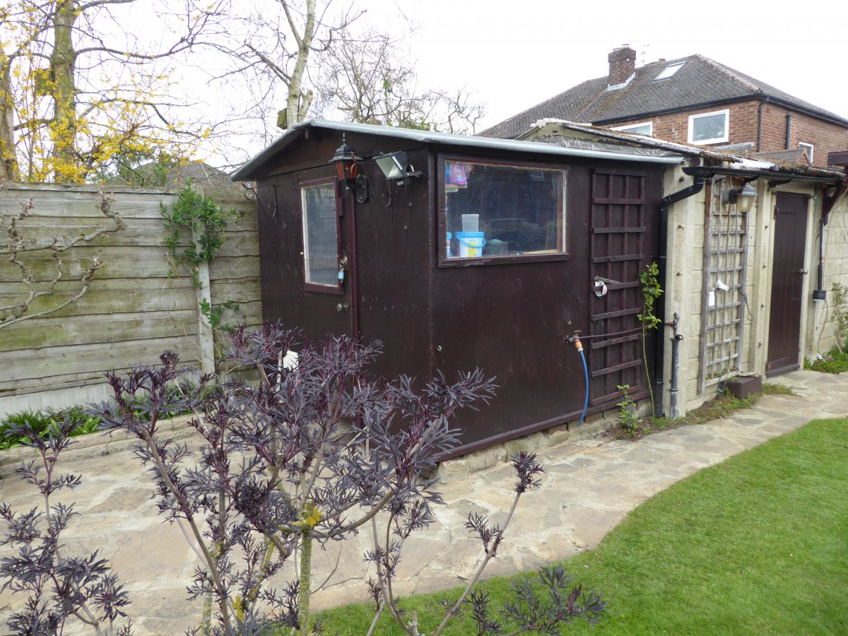

I built this with soft wood and 1/2" roofing plywood.
Coats of Dulux mahogany Woodsheen every few years has kept it in perfect condition, no rot anywhere.
This is a recent photo, it's also my avartar, it'll be thirty-two years old in September. I re-felted the roof ten years ago.
Same with this shed. That's a bit older, it's forty-three years old. I replaced the roofing felt for the second time in its life, a couple of months ago.
Roofing ply, (if they still make it), is ideal if you look after it. Even in places like Manchester in England, where we get quite a bit of rain.

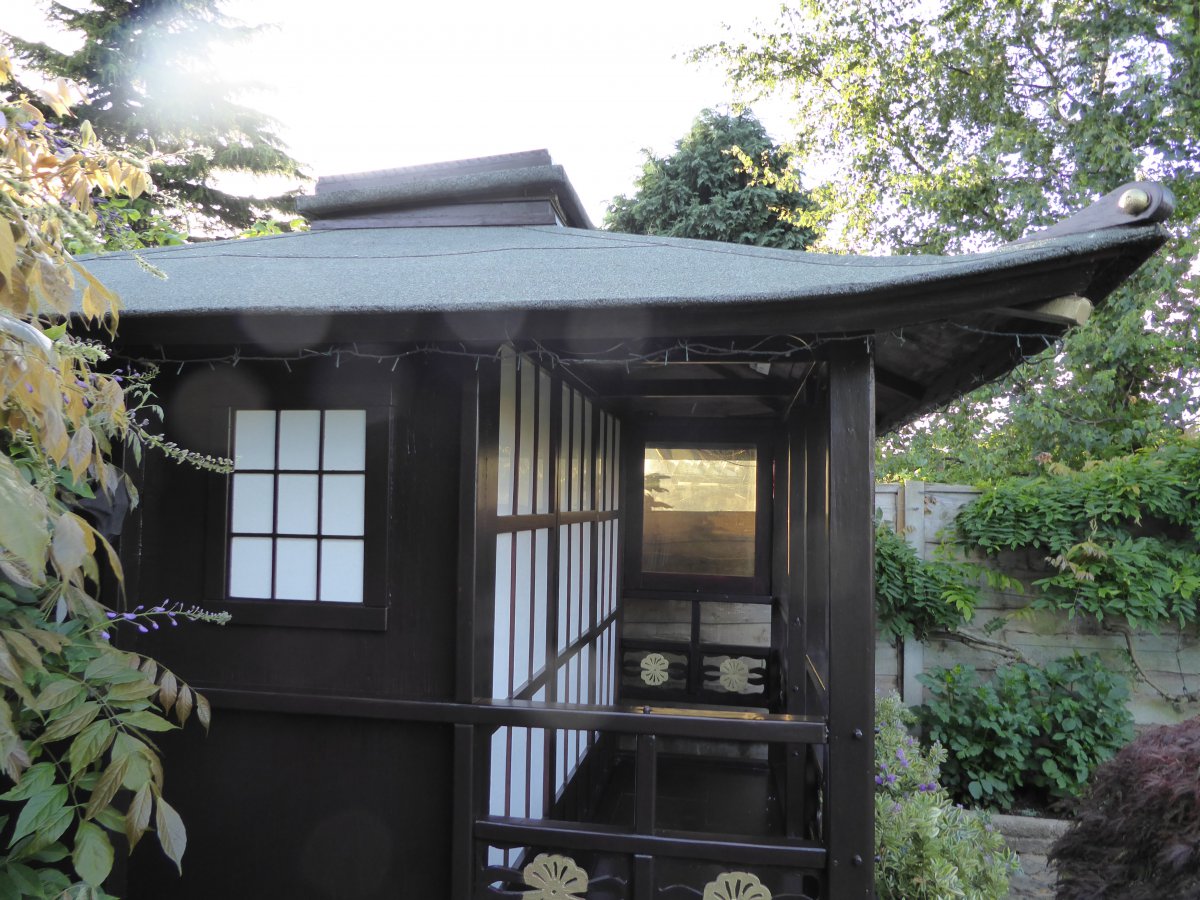

Here's the build video of our tea-house.

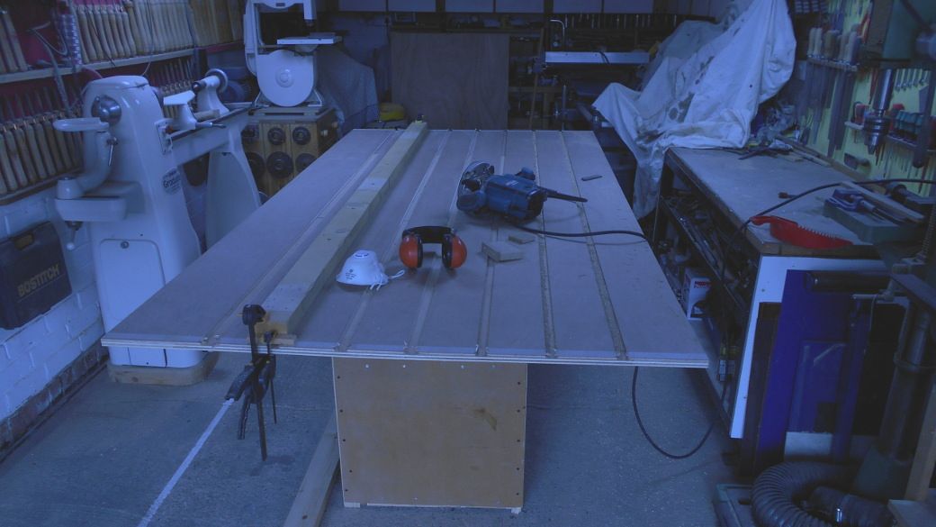

This looks very rough indeed; its 18 mm thick WBP plywood and is my new cladding being made by me; it's just an illusion but a good one and no one would know unless inspected very closely; I completely sealed back and front and all edges with top quality paint ensuring no bare grain remained; this cladding has now been subjected to weather extremes here on the exposed valley for the last four years; the original plywood panels are still in place but now covered by the new "cladding".

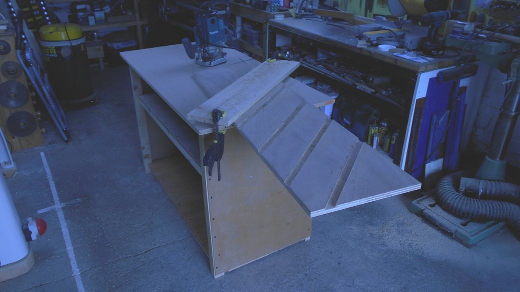

The large 8' x 4' plywood sheet being routed to imitate cladding; this is the big sheet of cladding seen above the garage doors.

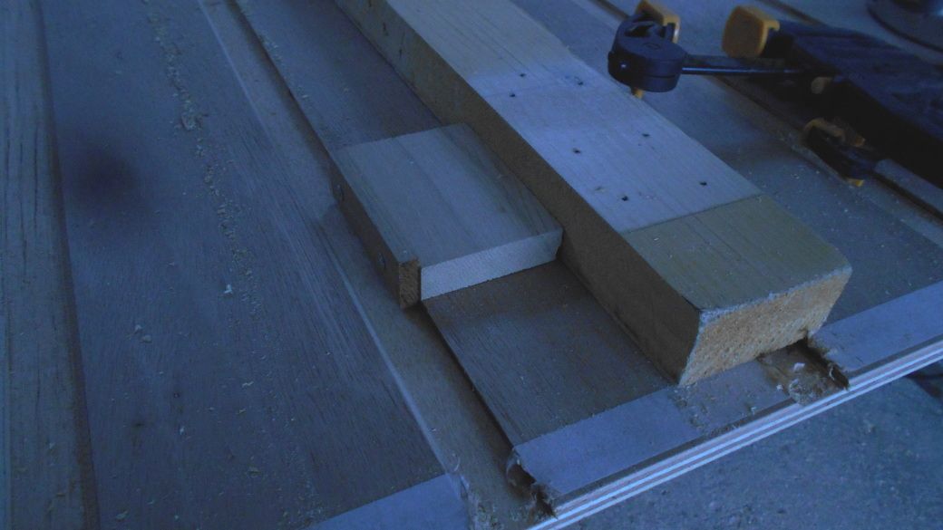

Here's how I achieved accurate router guide; the wide slot was cut in one pass and then the angles cut in two passes; I've never seen this done this way but thought I'd give it a go and it worked perfectly.

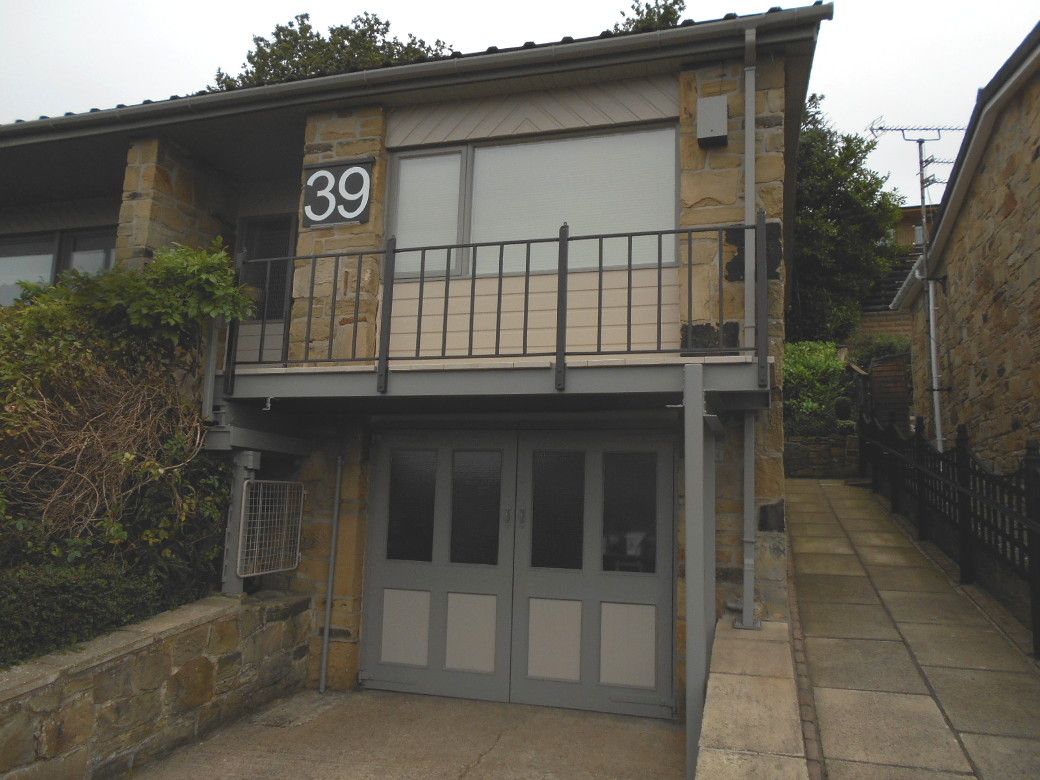

Our bungalow is constructed of random stone and timber. The bungalow was designed with an up and over garage door; I was fed up of having to fully open the door each time I wanted to access or leave the garage; my solution; make new side hung doors; these look attractive; certainly much better than the up and over door and now I can pop in and out without the slightest trouble. The decking steelwork I made and assembled; the decking is actually 40' long spanning the bungalow front; I designed and built the new decking but used heavy steel for support; the decking boards are scaffolding boards painted all around. The new plywood cladding was very cheap to make and is a big improvement over the original plain plywood panels.
To the left of the garage doors I created a storage area the bungalow length where I store aggregates and building material out of site the metal gate is salvaged from an industrial cage. To the right we had 9 steps which I removed by hand digging tons of wet clay; I came up with the sloping path idea and installed the path 17 years ago; 3 neighbours have since copied my idea and another neighbour has copied my deck steel structure; the fence too is bespoke being designed; made and installed by me; I had to design the fence taking into account the slope of the new pathway; I added a full length handrail and I finished the front steelwork with an handrail.
Just because something has been done a certain way for many years doesn't mean it can't be changed as long as sound common sense is employed. This is the way I do jobs around home and hope it gives you a few ideas to bounce around. Good luck.
