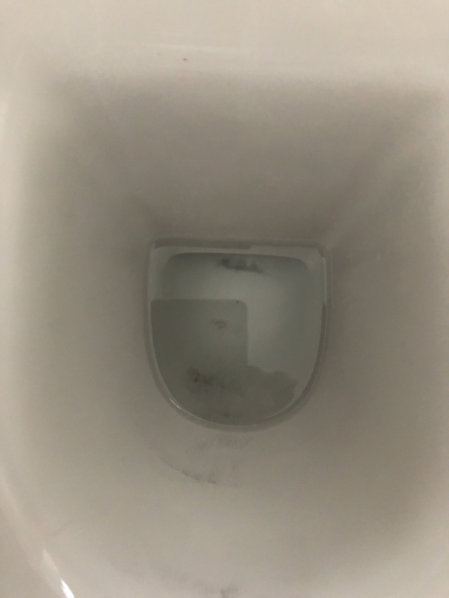

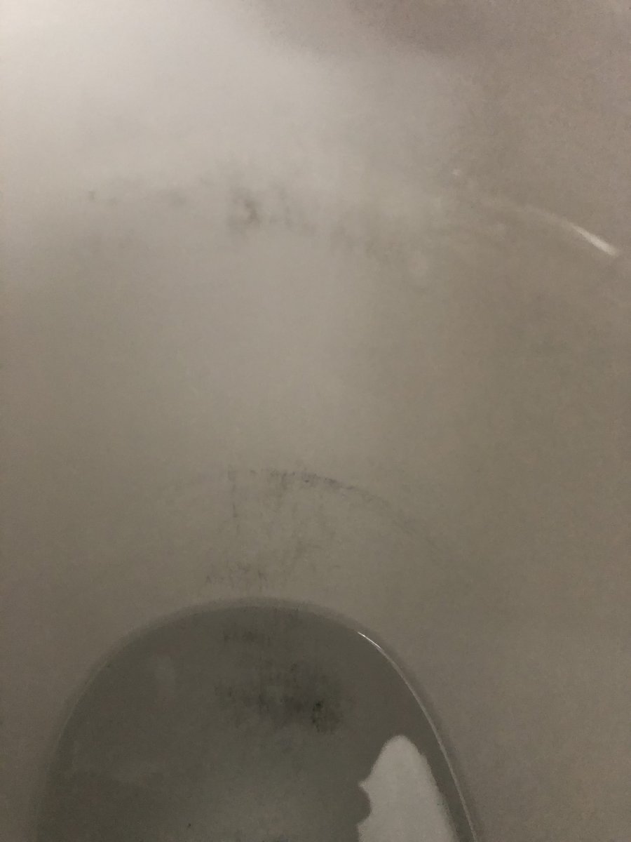

Hi Guys
Was wonder if someone can give me some advice. Anyone know how we can paint inside our toilet bowl to repair some small patches of damage?
Read somewhere that I should use Acrylic Spray Paint? we used a long metal wire to try and unblock our loo and its cause some scrapes

Hi and welcome.
To be honest, I don't think painting porcelain which will be constantly having water flow over is a practical idea, I also think it will look "dog rough."
You can get a new pan and cistern in Wickes for £47.

To do it right it needs to be reglazed by a professional.
I'd be surprised if a piece of wire could actually seriously damage the glaze - sure it's not just black deposits? Have you tried gently rubbing with scotchbrite on the accessible marks to see what happens? Or https://www.wikihow.com/Clean-Metal-Marks-off-a-Porcelain-Toilet
If it really is buggered then it's new pan time - painting isnae gonna work.
And in future, flush more frequently, and if necessary use a toilet brush as a plunger when the bowl is full of water. Learn what level of water is safe to flush again to get the bowl to fill but not overflow - often the sheer weight of water will do the trick.
