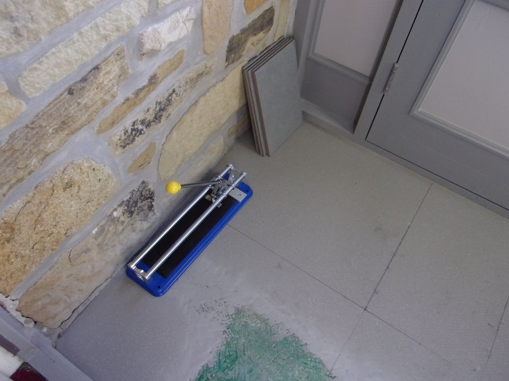

Next job is tiling and I've bought a cheap tile cutter from Screwfix;
https://www.screwfix.com/p/vitrex-manual-tile-cutter-330mm/37944#_=p
I'm impressed with the tile cutter given its very low price; I've not yet used it but it looks a decent bit of kit; I'll update on the tile cutter in due course.
The end is in sight for this porch project and I'll be glad to see the back of it. Once the tiles are laid I'll have a look at the electrics; I've bought two big coach lamps to restore and the door chime needs its push button moving; jobs are never ending but although I moan I'm never ever bored.
Out of curiosity I decided to try the new tile cutter yesterday cutting five 13" floor tiles and I'm impressed by how easy it was; no breakages so far.

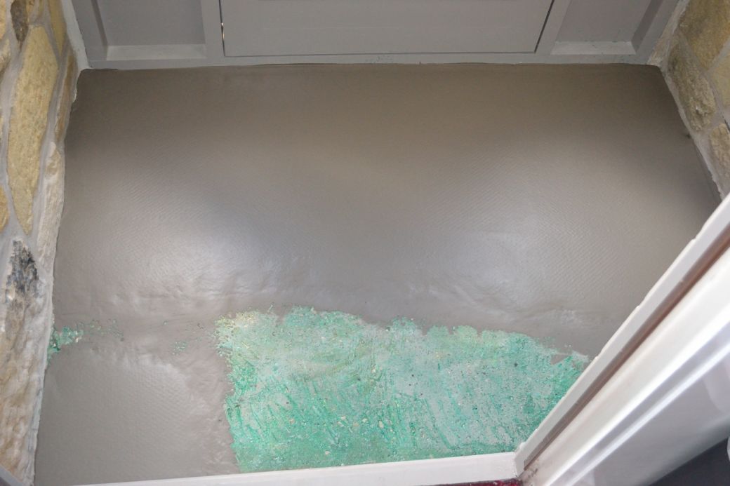

The picture below shows the porch floor with just one 20kg bag of compound laid
I couldn't see the image at this end, Colin - unless its the one with the tiles already laid? I'd really like to see what it was like before they went down, if you happened to take one :).
Thanks for asking Ian and I'm sorry if I've confused you so here's today's update. :)
The picture in post #23 shows the self levelling compound marked out for tile but no tiles yet laid. I'll include
a better picture below of the compound. The bare patch of concrete is the top of the slope and I didn't want to raise the floor level too much so only added just enough compound to get rid of the slope.

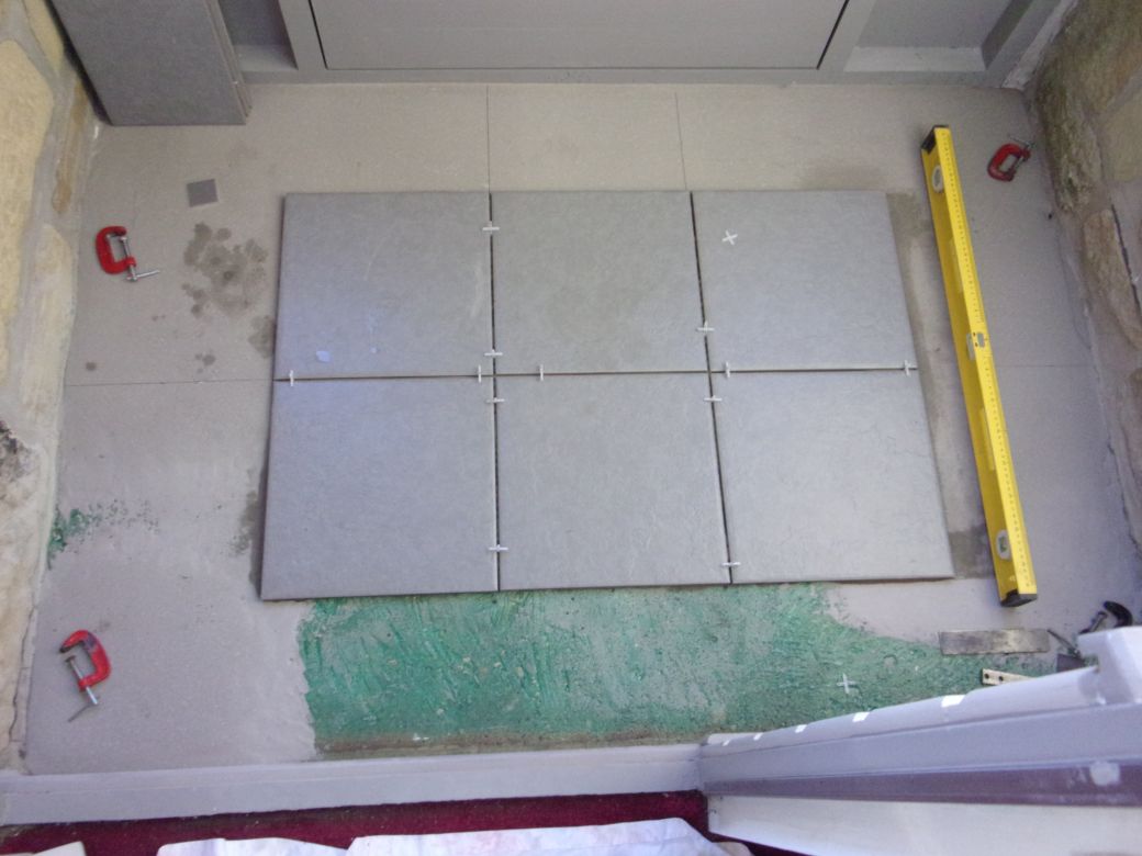

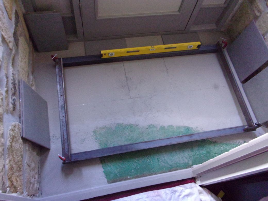

This morning I was determined to lay the six middle full sized tiles and I had declared all out war on this nothing but problem porch job. I don't get along at all with self levelling compound; if its me at fault I no longer care I dislike using the stuff. First job was a trip to our local timber yard; I wanted two 5' lengths of dead straight and true timber; I returned home without because these days dead straight true timber no longer exists at timber yards so I needed a plan "B".
Being a mechanical engineer I thought if timber doesn't want to play then metal will? I pulled out two suitable lengths of 2" x 2" heavy angle iron and yes these were straight without cupping; twisting; warping; bowing or loose knots so I'm in with a chance at last. I needed two short lengths to hold these apart at the correct distance and at first considered timber I had to hand but I'm sulking when it comes to timber then I wondered if my short home made sash cramps would be suitable these too heavy angle iron; yes they were just long enough so I removed the adjustable stops and adjusting screws.
This angle iron is heavy to play around with but at least it wouldn't need securing to the concrete. A rectangle was made using the four lengths of angle iron clamped very tightly at each corner; the tiles are 13" square so the distance was twice this plus 4mm for the spacers measured very carefully indeed and tested by placing tiles between them; enough has already gone wrong at every opportunity so now I'm being ultra careful because gremlins are at work. One of the long lengths of angle iron sat nice and level but due to self levelling compound not self levelling I had to pack up the second long length of angle iron ensuring both lengths were now true to the spirit level.
With the self levelling compound being so far out I intended to use the method shown in the excellent video above; I've used this method many years ago whilst plastering between wooden frames using the frames as guides so I know it works; with the angle iron gauging frame in position I needed a long adhesive spreading comb and these don't appear available at least not on eBay when I searched so I made my own bespoke comb. I had a suitable length of galvanized strip steel it being 3" wide and 29" long; longer would have been better but this would do at a pinch. Now notches needed cutting so what was my best option; I could use the angle grinder with a wide grinding disk installed but I didn't fancy listening to the grinder or having to don lots of safety kit; in the end I simply drew a line using a black Sharpie at just over 6mm along one edge this being the depth marker for the "V" cuts; it was a tedious job but my heavy snips made light work of cutting out the notches; I used a 4" combination square to mark the notches at 45 degrees which looked OK. Again I took a lot of care in cutting the notches otherwise accuracy of laying the adhesive would be lost. The ends were bent in the big engineers vice tapping over with an hammer; the pictures explain better but I made this long comb in less time than it would take to get one even if one was available. A strengthening piece of timber was added having drilled clearance holes in the comb to allow 16mm wood screws through. Now it was looking good and I knocked off for dinner.
After dinner I set about mixing tile adhesive in a plastic bucket adding water first then pouring in the adhesive powder which created a small fog; a wooden stick was used for mixing; this isn't the best method and I have a paddle mixer but the warning on the adhesive bag advised swift working especially for a novice because this adhesive is rapid setting; I didn't want my paddle to be messed up with rock hard adhesive whilst I laid the tiles; being new to floor tiling one problem I had was judging the amount of adhesive to mix for six of these tiles; I guessed at one and a half litres of water adding adhesive powder until I thought the mix was just right then the panic as I shot up into the bungalow to get the tiles laid before the adhesive started to set; once the adhesive starts to set it mustn't be reactivated by adding more water which seriously weakens it; I was a bit short of adhesive so in a panic I mixed more and at last the six main tiles were laid.
Working in such a confined space proved very difficult indeed; had I been a ballet dancer I think it would have been easier; I thought if I could lay these six tiles and let the adhesive fully set then I would have a better chance of laying the perimeter tiles each of which needs cutting? I'll have a go laying the perimeter tiles tomorrow allowing the adhesive on these six tiles to fully set before I walk on them because although the instructions state the tiles can be walked on after three hours I no longer believe anything. One thing is for certain; this adhesive is definitely rapid setting and and I quickly found this out as I cleaned the tools and angle iron. With the angle iron frame removed I used a bucket of clean water with washing up liquid added to wipe over the tiles so now I'm all set up for tomorrow.
All this seems very long winded but then I'm a novice at floor tiling so I've added all the problems I've encountered and explained how I got around not being able to buy a long adhesive comb; here are up to date pictures.
A better picture of the self levelling compound; its deepest nearest the spirit level tapering to zero where the concrete is seen; the angle iron frame is being used as a depth gauge doing the job that the self levelling compound should have done.

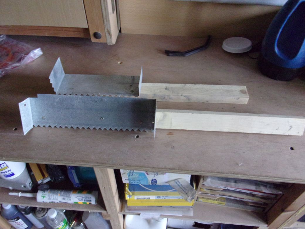

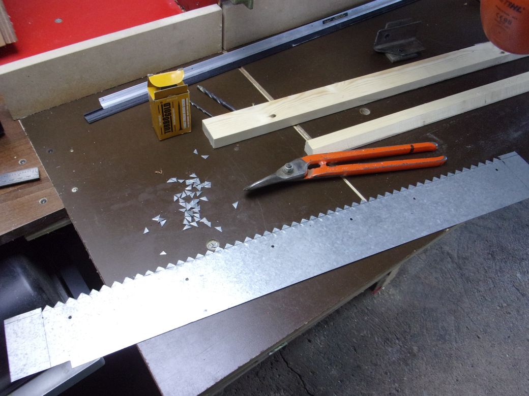

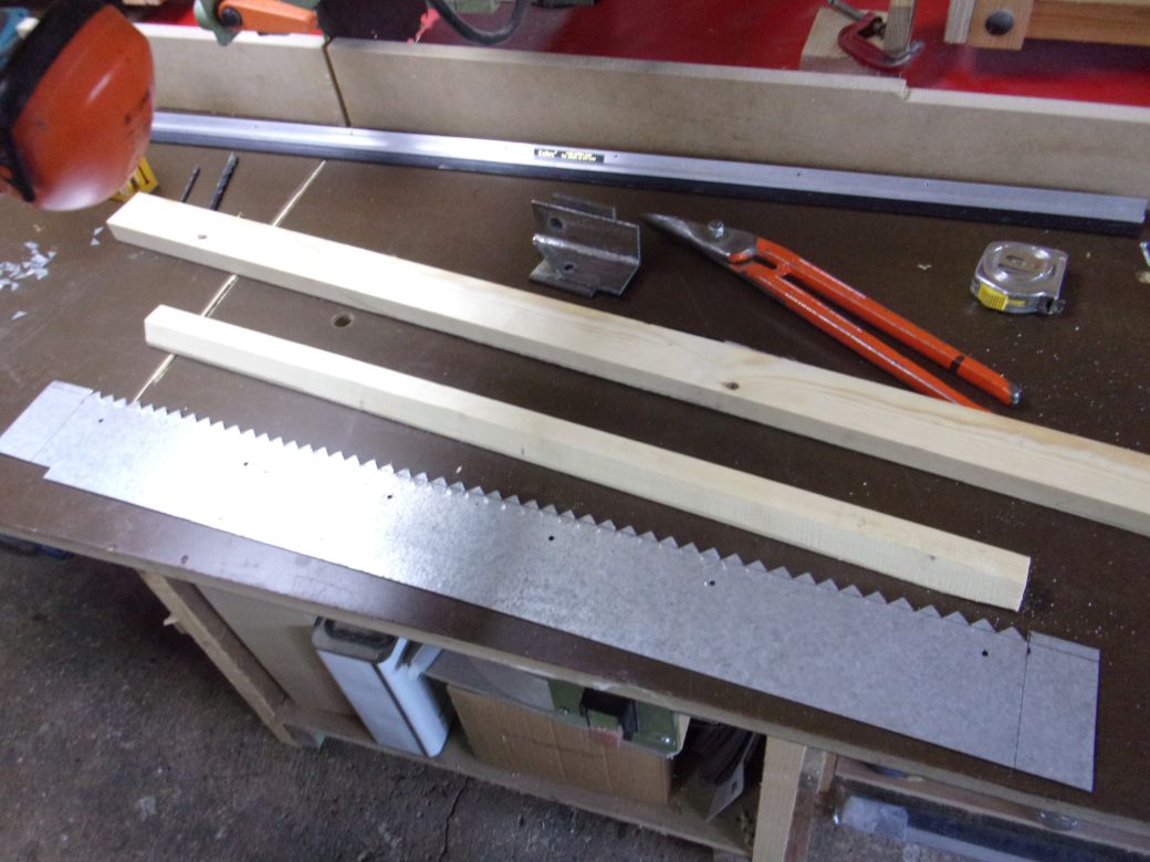

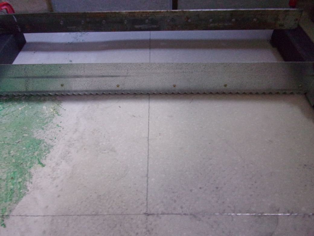

I couldn't buy a long adhesive comb but this didn't stop me; I made my own costing nothing.
I ensured every small triangle cut out went into the bin and not into the Yeti's tyres.
The long adhesive comb in position ready for spreading adhesive.

Just six floor tiles causing so much hassle and work but now fully laid; perimeter tiles to be cut and laid tomorrow all being well.

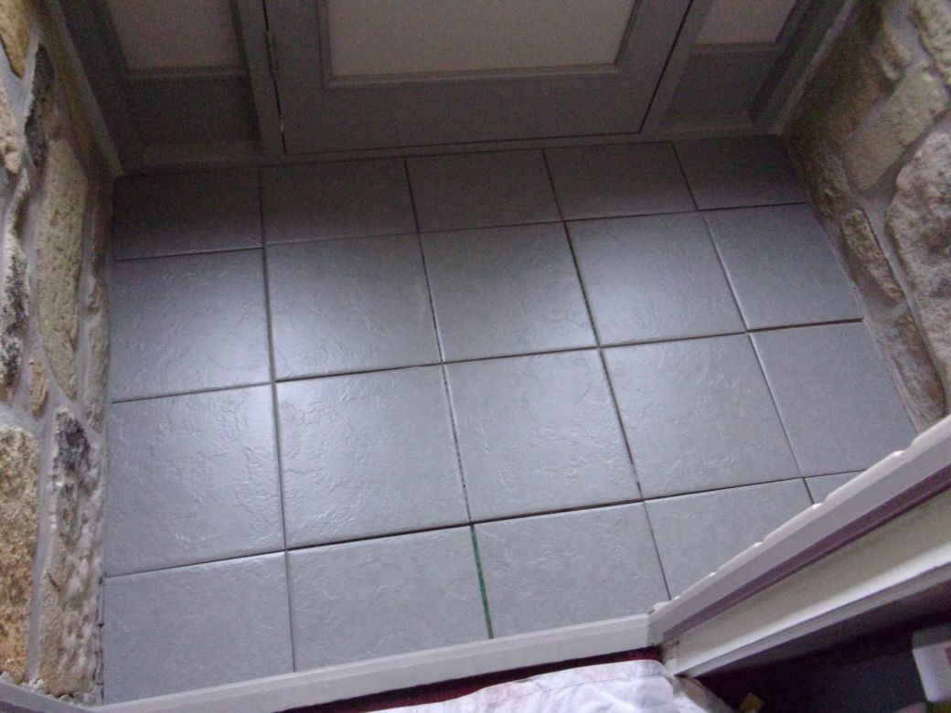

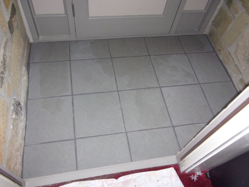

Not being used to grouting it's taken most of today to grout these few tiles; the biggest mistake I made was to mix the grout too wet; the next big mistake was to try using the old sponge I've used for car washing to clean the tiles after grouting expecting the grout to simply wipe away as easily as I see it done on YouTube; it wasn't behaving because I'd forgotten about the sponge retaining car shampoo ending up with a bucket of suds but as usual I learn the hard way; a fresh bucket of cold water and brand new sponge sorted it out. I've just given the tiles a third wash with clean water and at last this front entrance project is a success it now being finished and I can walk away from it.
Tomorrow I'll hang pictures then start on the electrics adding lights and sorting out the door chime; Bron is delighted saying its brilliant so I'm now pleased and can stop moaning about all the things that wound me up as work progressed. :):):)
Grouted and drying; tiles looking good after a third wash with clean water. Job finished.

I left a comment on Roy's YouTube video explaining I had searched for the adhesive spreading tool without success and Roy kindly replied giving me details where to buy them but a quick look it appears Roy lives in Australia; living here in the UK the job could be done whilst awaiting delivery as I've just demonstrated; I used 6mm notches whereas checking Roy's instructions his are 10mm; I don't think it makes any difference because the beads go down perfectly level.
Below is a picture of the adhesive spreading tools I made; I made the tool long enough to lay 26" wide adhesive this being two tiles width; once the full sized tiles were laid I then cut the tool to suit the perimeter tiles.

Two home made adhesive spreaders costing me nothing being made of offcuts. Short lengths of 2" x 1" timber and an offcut of galvanized steel sheet.

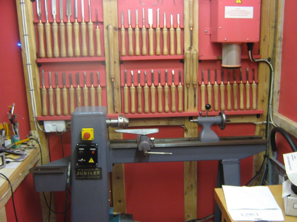

I've used this same room as a workshop making lots of furniture and woodturning.

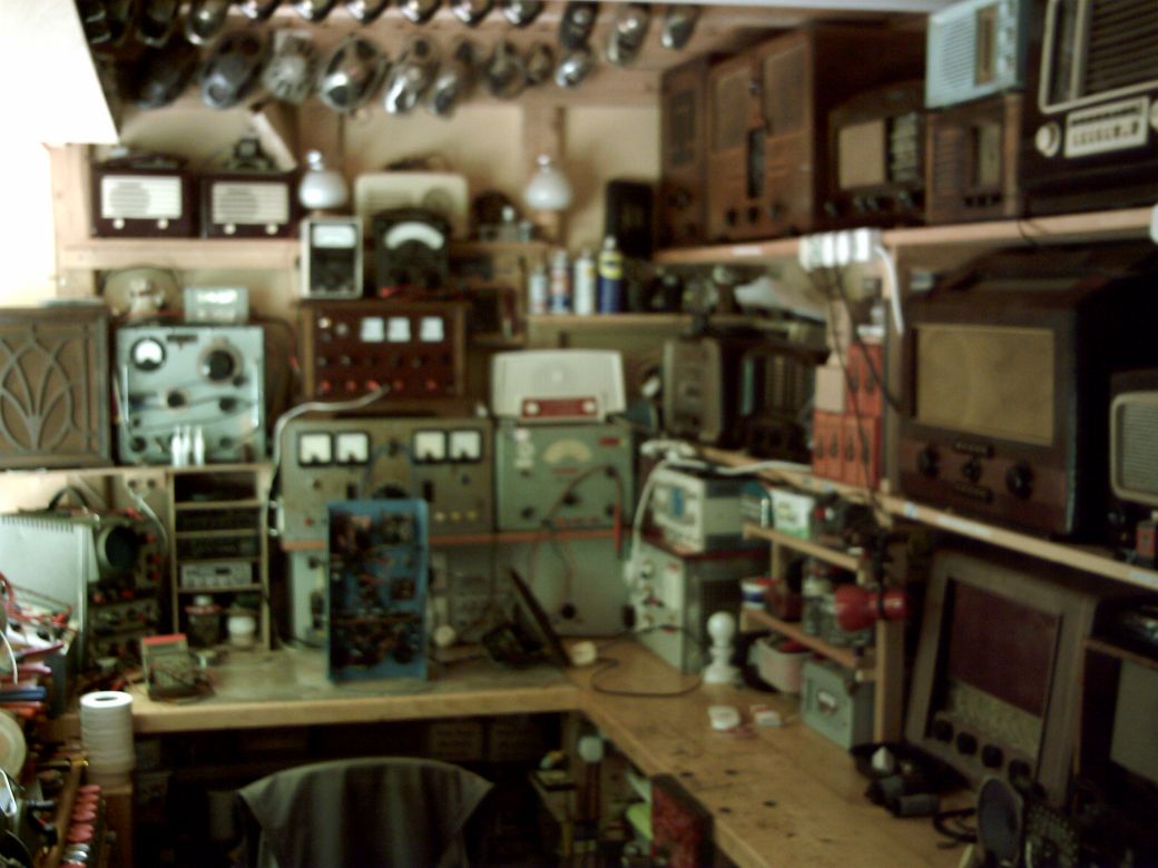

I also spent ten years in the same room restoring vintage valve radios where it was crammed with radios and test equipment. Now our car sleeps out I use the garage as my workshop so Bron now has a wonderful studio to work in.

Please be very careful mixing grout; it takes very little water; my grouting looked a mess but I struggled through; I know I was on a steep learning curve but if only one thing had gone right.

I enjoyed my ten years with vintage radio restoration as my hobby; the radio shack evolved as I gathered more radios and test equipment; I could restore both the chassis and the cabinet in fact I made all the mistakes possible whilst learning French Polishing and Veneering from scratch. Veneering was very difficult to grasp until I realized both sides of the veneer needed to be wet otherwise the veneer curled up in disgust; as I say I suffer constant bad luck and I'm out of timing with the world; I suffered just about every mistake to be made whilst learning veneering then straight away I found this following absolutely brilliant veneering tutorial on YouTube;
