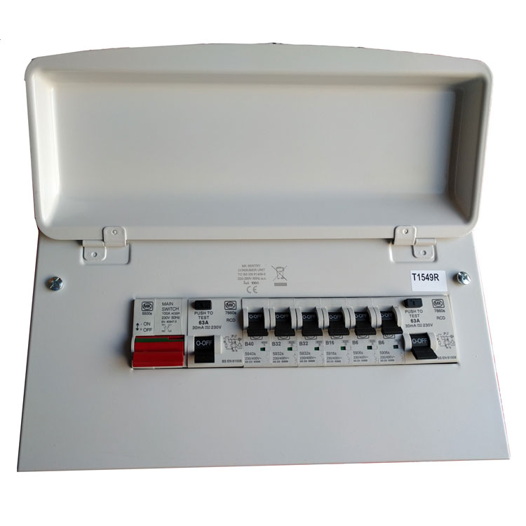

I don't think we've enough information.
The lamp blowing should only trip the mini breaker for the lighting circuit. This can happen when a lamp blows while the light is on, or blows when you turn it on.
There's been no mention of a mini breaker. There should be one for every circuit in the house.
If it blew the main breaker, then something else is wrong.
This is a typical consumer unit.
A lamp blowing should only trip one of the six mini breakers in the middle.
Not the main breaker.
