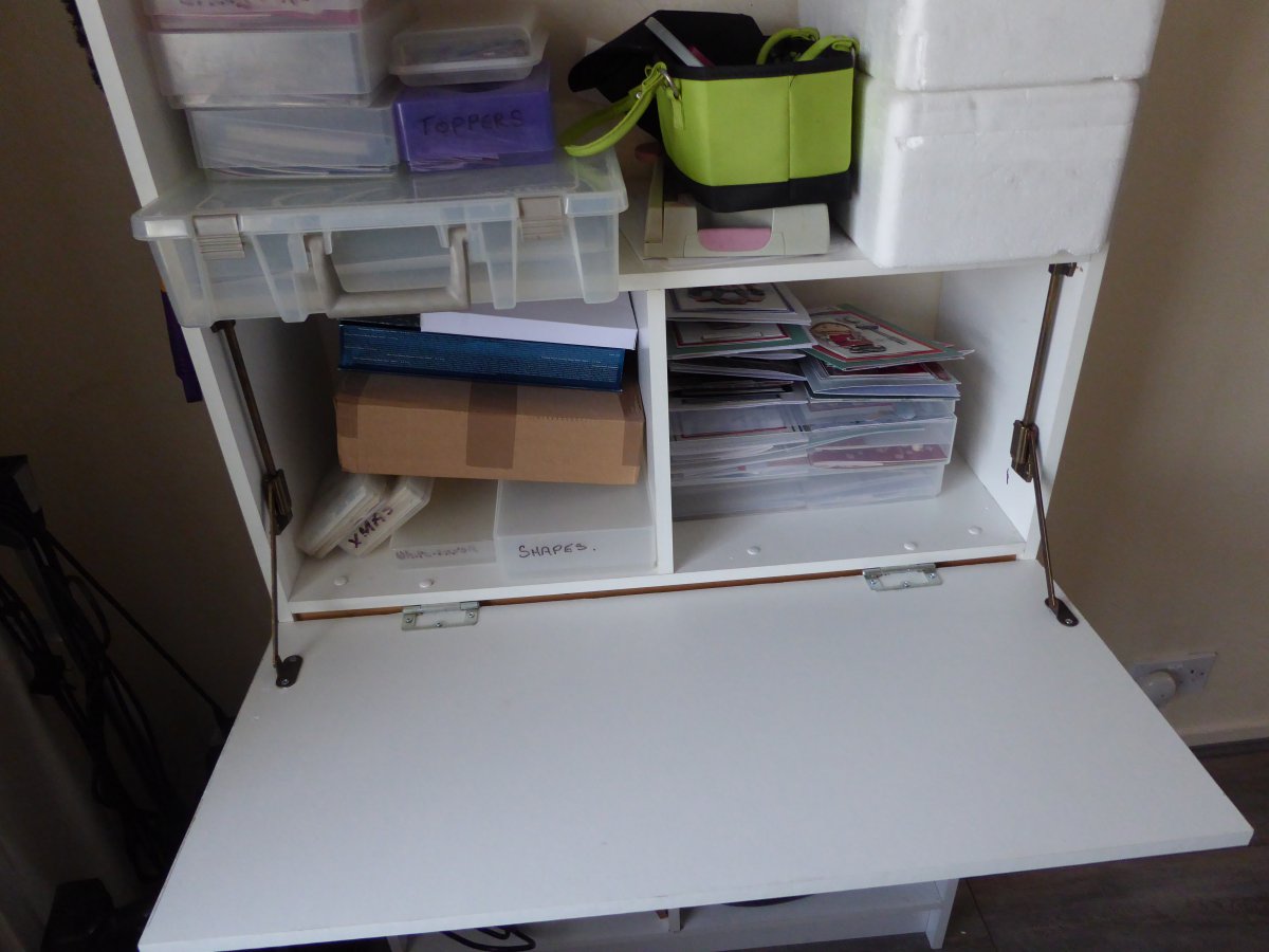

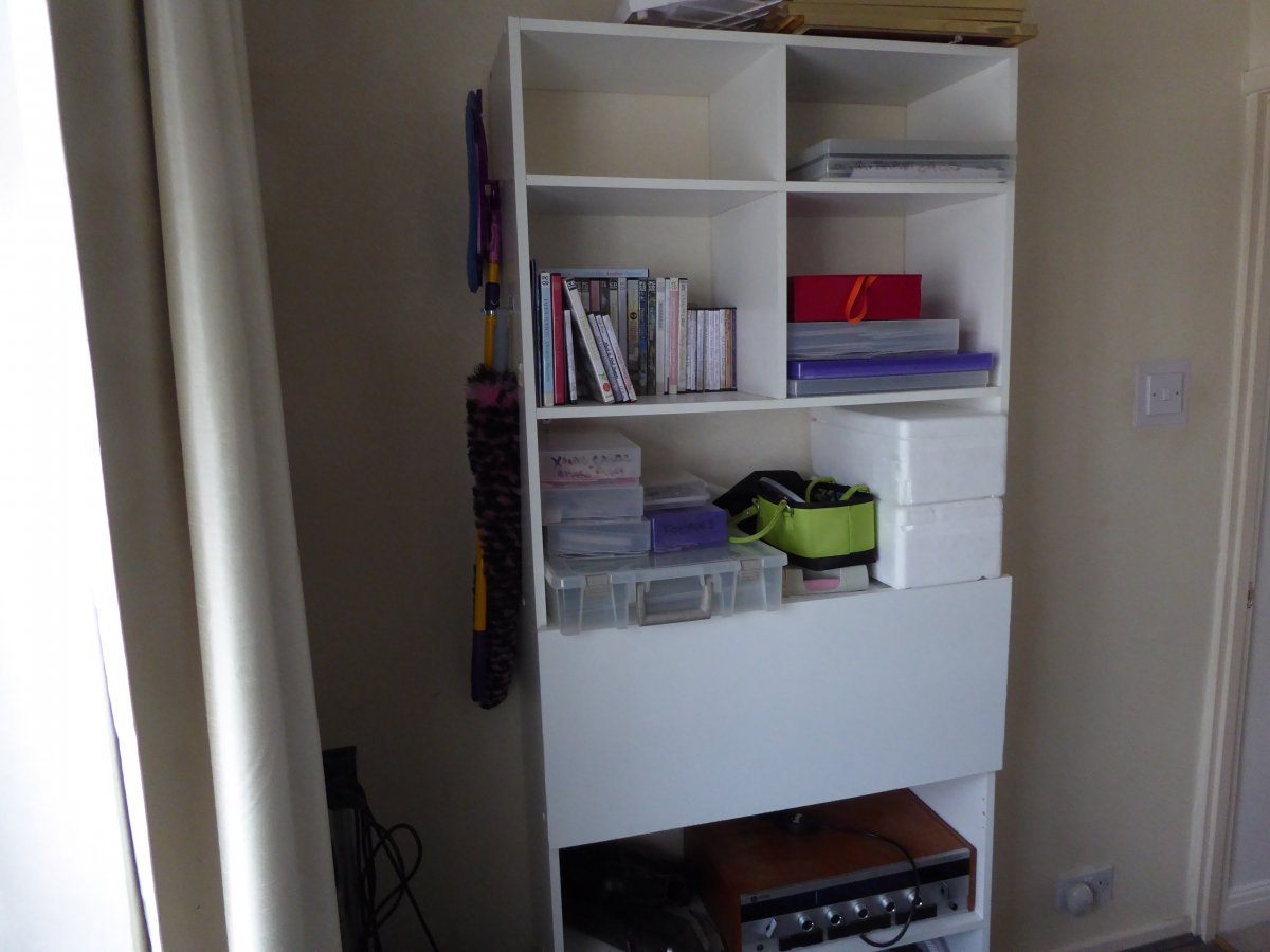

A cabinet with a fold down table for my wife for her decoupage card making stuff.

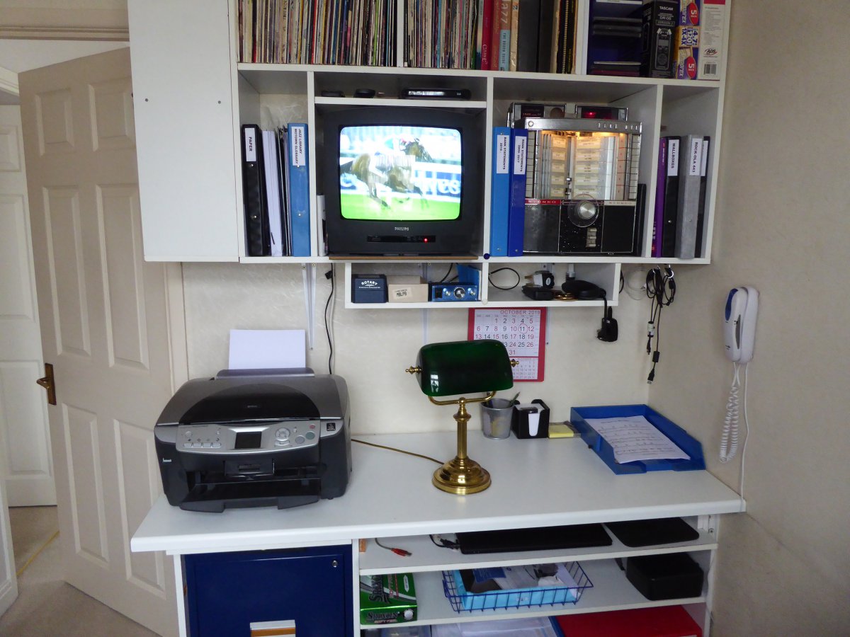

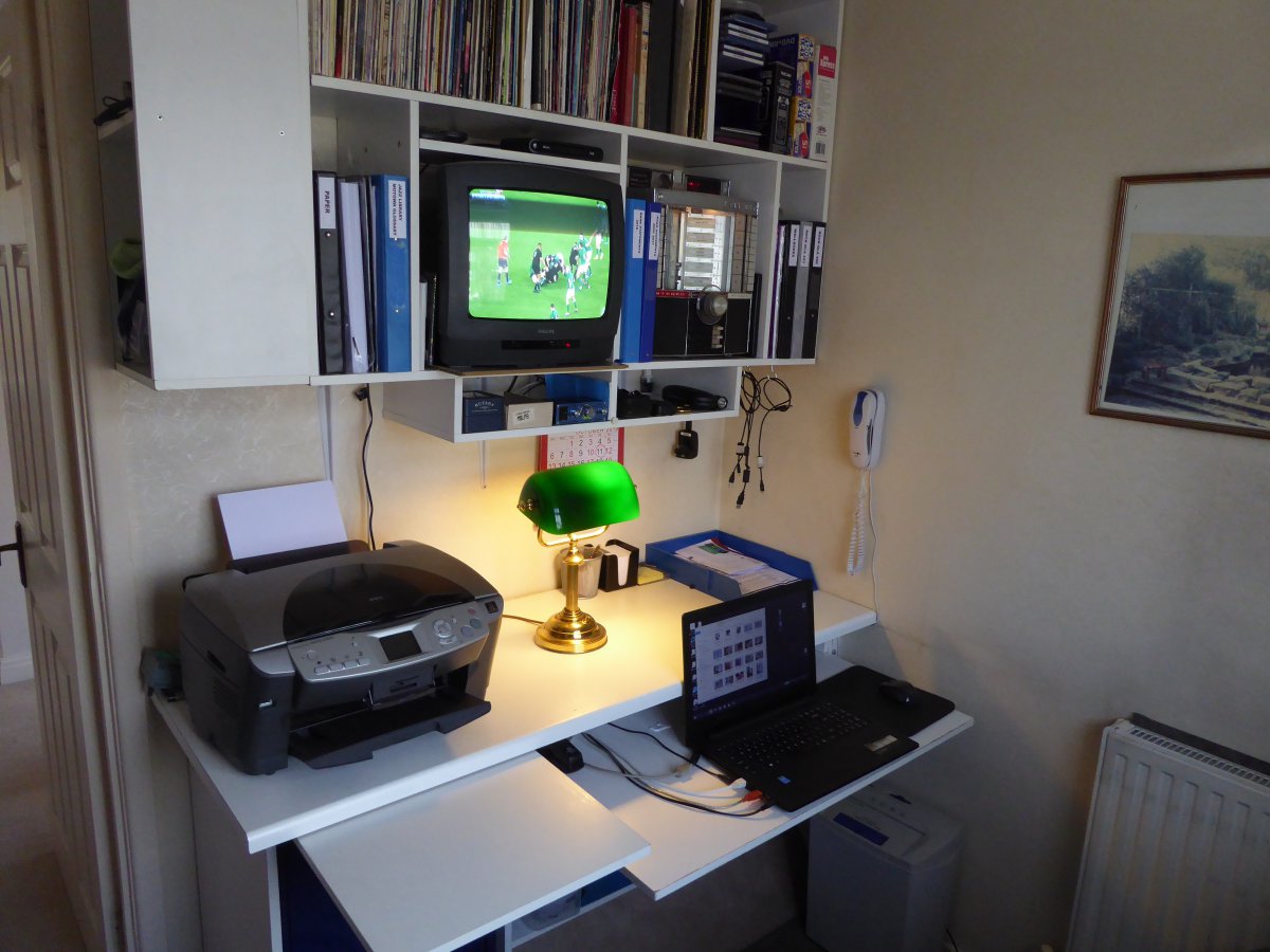

and this for my stuff. The desk is a piece of worktop. The weight is taken by three sturdy brackets, plus two more small ones at the top to stop the whole thing leaning forward. Those old vinyl albums are very heavy, plus there's an old CRT TV and a jukebox wallbox.
The working surfaces can be slid in, when not in use.

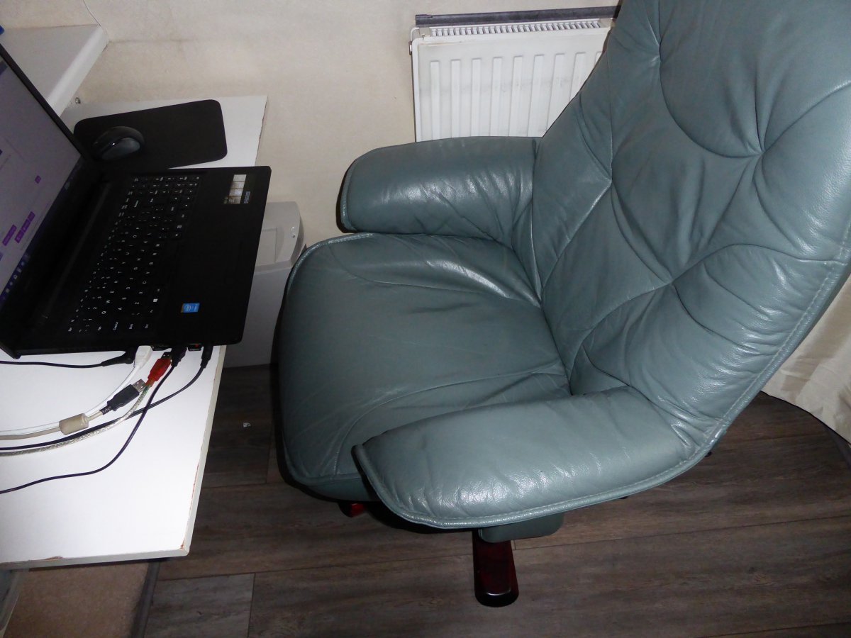

The table on which my laptop sits is at a height that suits this reclining chair which was replaced in the lounge by one of our "Stressless" recliners. It's lower than a normal office chair.

For anybody who wants an office which doesn't have to be part of another room, so that "functional" can be perfectly OK, fix Spur uprights to the wall, and sit the worktop on the deepest brackets they do. It will need to be screwed on as they don't come far enough forward to stop it tipping up if you lean on the front edge, but once screwed down it's fine. Set it away from the uprights by the depth of a lenght of worktop upstand, which can just drop in/lift out there to make it easy to pass plugs through.
Have long uprights running above the desk surface and hey presto - a place for any shelves you want.
The height of the desk, and the spacing of the brackets that you need means that a low filing cabinet like this can slide underneath
and the whole structure is strong enough to support the heaviest printer.
The sort of desk and units I made lend themselves to alterations.
I first put this together, getting on for twenty years ago.
The little 14" TV gave up the ghost a few months back.
Last week I acquired another vintage tuner/amp, so I decided to swop it for the little amplifier I was using to play mp3s on my laptop through the speakers, of the vintage jukebox wallbox.
I had the extra shelving cut to size by a wood yard and put it together in a few hours on Friday afternoon.
The whole shelving unit sits on three sturdy brackets and there's two wall fixings securing the shelf under all that vinyl and two more at the top.
The two shelves below the retractable one on which my laptop sits can also be slid out to get at the plug socket bank on the wall.
If necessary the metal filing cabinet can also be pulled out.

I did alter and add a bit to it, to accommodate a vintage Rotel tuner amp
Then again, when I decided to add a couple of bookcase speakers as I hadn't made the bottom shelf long enough.
