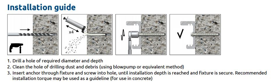

For screwbolts, you'd use a drill bit the same diameter as the core of the bolt (minus the threads). I assume it'll be a 6mm bit you'll need - but line it up and make sure it is the same diameter as the main shaft of the bolt - the threads need to cut in to the concrete.
Once you've drilled the pilot hole, use a socket set to screw it in.
