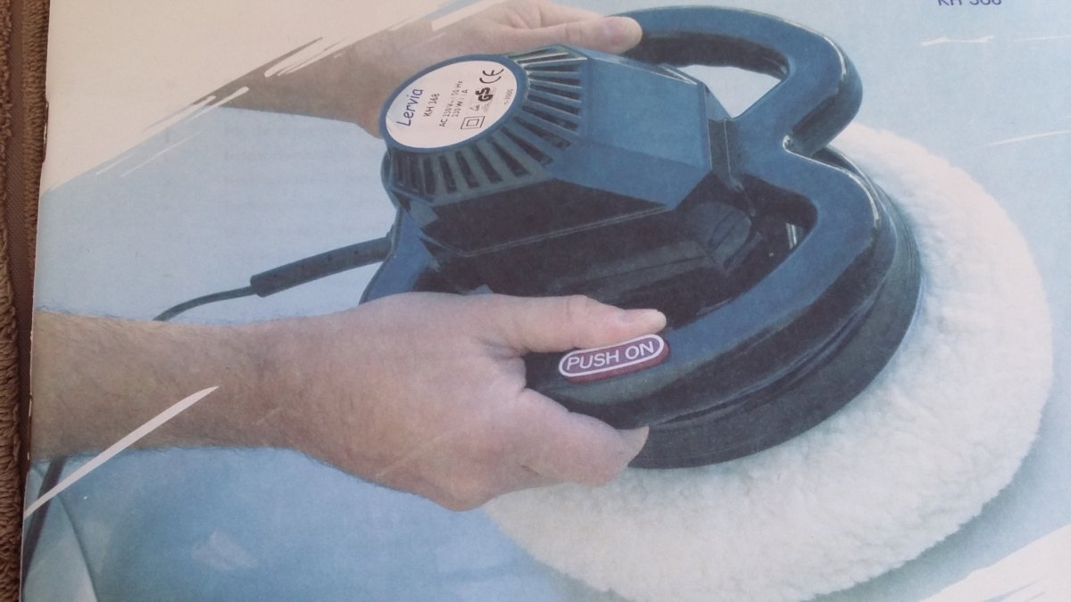

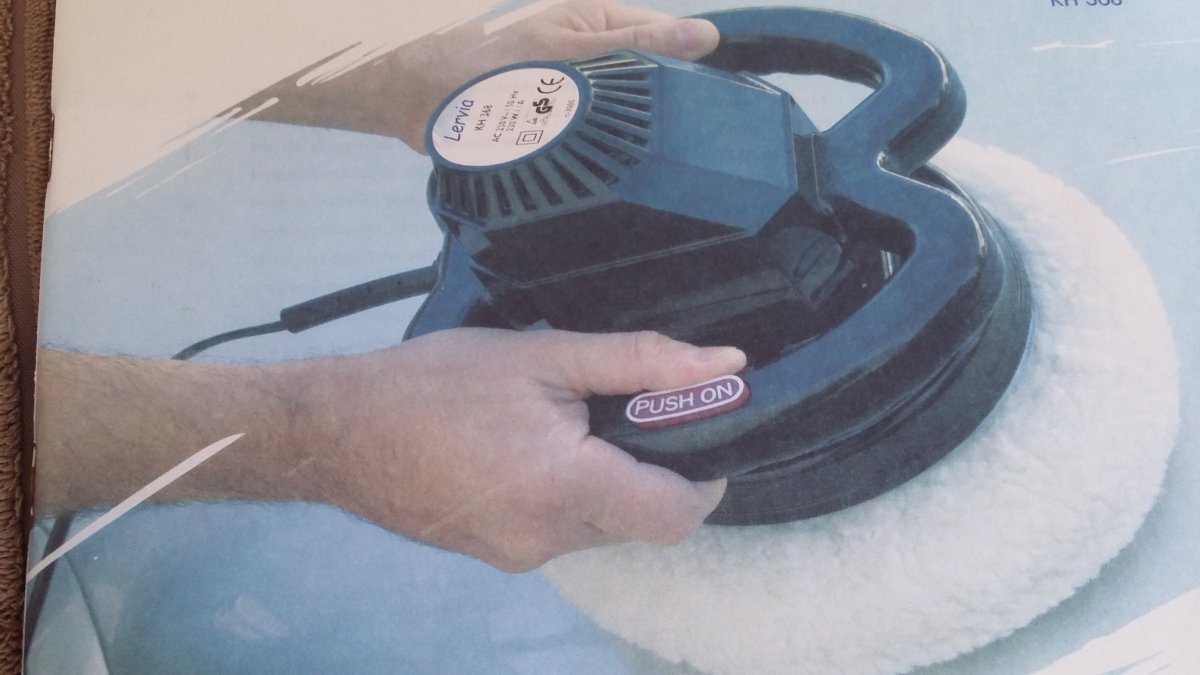

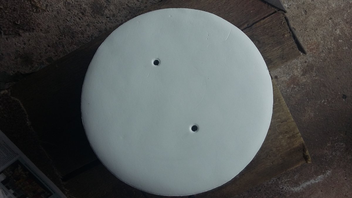

Hi. A few years ago I bought a Lervia KH 368 mains polisher. Finally got around to using it yesterday. It wasn't expensive so I wasn't expecting much. The 10 inch polishing mopp fits with tight elastic around the edge. The pad fitted to the polisher is foam with what looks like a thin polished piece of white hard foam stuck to it. Trouble is when you switch it on the pad wizzes round in an eliptical motion but the polishing mopp doesn't stick to it. Can't really see how it can because the pad is so shiny. Sorry but that's the best I can describe it. I'll try to attach a couple of photos. I always thought these sort of pads were held on with Velcro. Thanks

Hi. A few years ago I bought a Lervia KH 368 mains polisher. Finally got around to using it yesterday. It wasn't expensive so I wasn't expecting much. The 10 inch polishing mopp fits with tight elastic around the edge. The pad fitted to the polisher is foam with what looks like a thin polished piece of white hard foam stuck to it. Trouble is when you switch it on the pad wizzes round in an eliptical motion but the polishing mopp doesn't stick to it. Can't really see how it can because the pad is so shiny. Sorry but that's the best I can describe it. I'll try to attach a couple of photos. I always thought these sort of pads were held on with Velcro. ThanksView attachment 2923
Hi - I have a similar polisher, the hard foam pad could use a softer sponge outer pad layer to grip the polishing mop. When my original outer pad deteriorated, I cut and glued a 3/8" thick sponge upholstery pad to the foam pad surface to hold the polishing mop in place.
