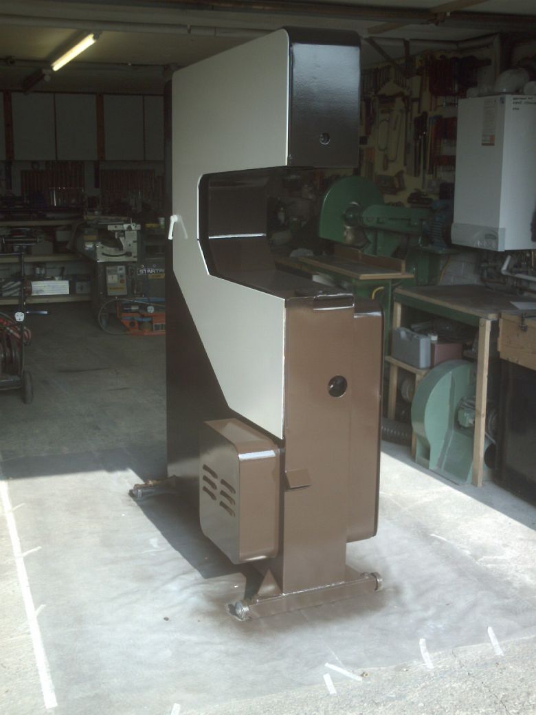

My Startrite Volant 24" nearing full restoration.

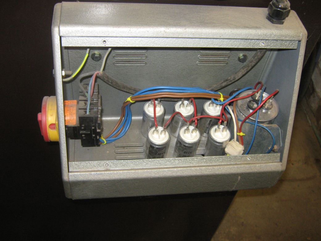

This Startrite is a big industrial bandsaw on 3 phase 415V and I was running it through my own huge transformer powering it on 415V but from our domestic 240V supply; these are the capacitors used to phase balance the motor to the transformer; the transformer wasn't a static converter it was a purpose built transformer wound by me and it behaved just as if 3 phase 415V supply was laid into the workshop. Much too complicated and dangerous to fully discuss here; I've since sold my big 3 phase machinery and the transformer is now with an electrical engineer so I know its in safe hands.
