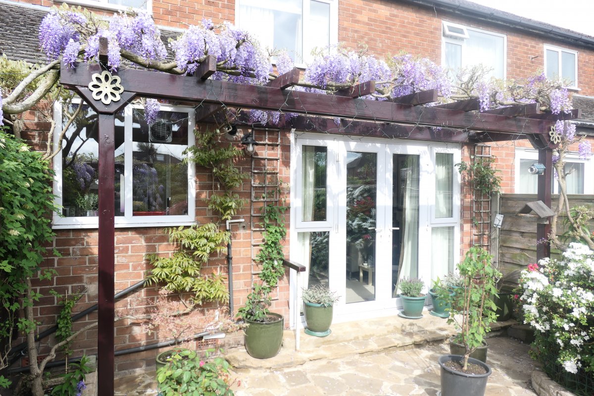

This is our pergola on the back of the house. It's just tanalised soft wood.
It has "concrete "elephants feet" to keep the bottom of the two posts off the patio.
There's plywood caps on the tops, with silicone sealant between them and the top of the post.
They've been OK for over 20 years.
