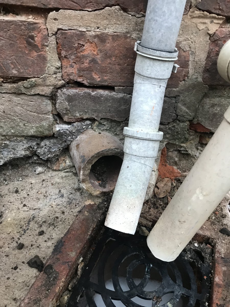

What is this clay pipe ? Nothing ever drains from it .
Jan 29, 2022
It’s a Victorian house, nothing has ever drained from it ?

Could be an old now redundant drain?
If you have any drain rods ? try them end sea how far in the pipe travels ?
Ken.
Jan 29, 2022
That’s what I thought it might be , but why would it be left open and not blocked up ? Would it be ok to block it up ? Many thanks

Suggest you if possible? have a look up the pipe, a very strong torch and a mirror??
If no water has ever flowed? sounds like a redundant pipe,
What has possibly happened is hat the old pipe is a similar size as a sewer pipe from [say] a toilet. If the property has had several make overs then that could account for the pipe?
Should be possible to chop the pipe flush with the wall and fill with cement
