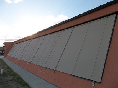

Yes, we have outdoor shades that we retract on hot, sunny days. With the berming on the North side, the house stays nice and cool all day long. Of course the cool Colorado summer evenings, around 60 deg F helps. We open up the house at night for cooling in the summer. No A/C.

Yes, we have outdoor shades that we retract on hot, sunny days. With the berming on the North side, the house stays nice and cool all day long. Of course the cool Colorado summer evenings, around 60 deg F helps. We open up the house at night for cooling in the summer. No A/C.View attachment 257
That's Good it's really a smart way to cover your open space and save yourself by facing sun rays.

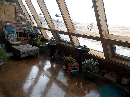

I guess, in England, there's not a lot of passive solar design. However, here in Colorado, where we get 324 Sun-days per year, these designs are extremely efficient. We have electric heaters *required by code). The circuit breakers are OFF, because we don't need them. We also have a woodburning stove, which we've only used twice so far, this Winter. The incredible thermal mass and sealing and insulation of the home, hold the heat in incredibly well. Formula in Winter: 1. Heat home during day (usually Windows have to be opened, even during cold days). 2. Close windows in late afternoon. 3. As the house cools (mostly thru glass - the outside air often gets into single digits), the walls, floors, tile, etc, all start releasing heat. At this point, if you're in the house, it sometimes starts feeling hot. 4 Process repeats in the AM.
