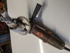

Without extensive training and at least a bushel of experience I suggest you forget about using a freehand angle grinder of any size on wood with a blade designed for wood and certainly not a 7 inch. That's nothing but a free hand disaster waiting to happen.
For stone cutting I recommend a guide so the grinder can be controlled rather than totally free hand. You may need to construct your own guide because Bosch is the only one I see available for a smaller grinder. As you will quickly discover direction of travel with the grinder in relation to the rotation of the blade/grinder wheel is of importance for safety. And speaking of safety NEVER LOCK THE TRIGGER / SWITCH in the on position if your grinder has that function. A full face shield is also
something else I recommend.
In my opinion this is one of the most dangerous tools available. Pictured is a hand and grinder ( NOT MINE ).
Also pictured is my Jack Shirt tail when I was slightly complacent using a Cupped Wire Brush with about 60 years experience under my belt.
For stone cutting I recommend a guide so the grinder can be controlled rather than totally free hand. You may need to construct your own guide because Bosch is the only one I see available for a smaller grinder. As you will quickly discover direction of travel with the grinder in relation to the rotation of the blade/grinder wheel is of importance for safety. And speaking of safety NEVER LOCK THE TRIGGER / SWITCH in the on position if your grinder has that function. A full face shield is also View attachment 3536View attachment 3537something else I recommend.
Also pictured is my Jack Shirt tail when I was slightly complacent using a Cupped Wire Brush with about 60 years experience under my belt.View attachment 3538
